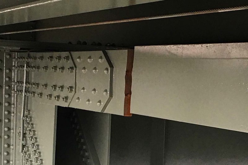

The approaches for the bridge are continuous trusses. I read the story in my local paper over the weekend but the report didn't identify a location on the bridge. Assuming it's over a support, and given the age(notice the rivets) I'd guess brittle fracture.

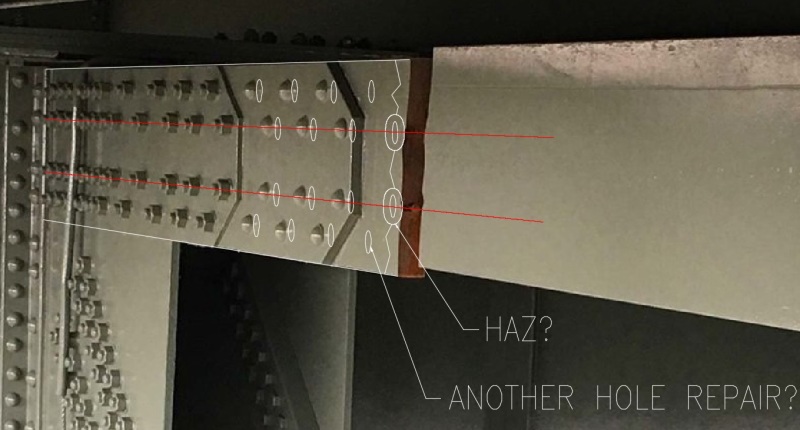

If you zoom way in, there do appear to be two regions of discoloration in line with the bolt holes further down the member.

Here's the photo - you can see irregularities in the edge along the fracture that are in line with the bolts further down:
RE: Delaware River Bridge Closure
My first question when I saw the photo was "Why did the crack propagate there?" I would have expected it at one of the holes.
Lomrandil - star for posting an article with a reasonable answer. Thanks!
Looks like the crack is offset from where the holes would theoretically be.
Teguci - that's what I was thinking - there definitely is an irregularity at the fracture in line with the bolts/rivets.
