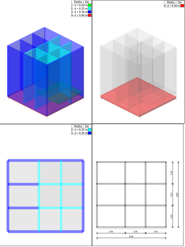

I have never done something like this before. I did circular silo before, but with this I feel kinda uneasy...
Im wondering what to expect - problems, advices?
Silo is for wheat and its 9 meters heigh.
Outer (and some inner) walls are concrete - 30 cm thick
Rest of the walls are 25 cm thick.
Foundation slab is concrete - 40 cm thick.
Load:
WHEAT: density: 8 kN/m3, angle of repose: 30 degree
koeficient for pressure: k0 = 1-sin30 = 0,50
Max horizontal pressures on the walls: 9 m x 0,5 x 8 kN/m2 = 36 kN/m2
Max vertical pressures on the foundation slab: 9 m x 8 kN/m3 = 72 kN/m2
What do you guys think? Advices, suggestions?
Dimensions of walls, slab normal/expected?

I did something similar to this some years ago. One of the main things I would tell you to look out for is: pattern loading. In other words: since this thing is multi-celled, there may be a possibility that cells off center will be filled while others remain empty. (That will (of course) produce unequal bearing and more overturning moment.)

I'm not an expert on these but isn't there a loading associated with situations where the contents hang up on the walls, forming a sort of arch, and then have a type of dynamic impact loading when the arch lets go and drops the contents?
