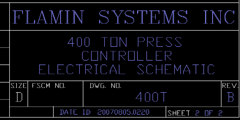

Geez. I not only put the DAY in my drawings I include the hour and minute! Every time the file is saved I update the time.
