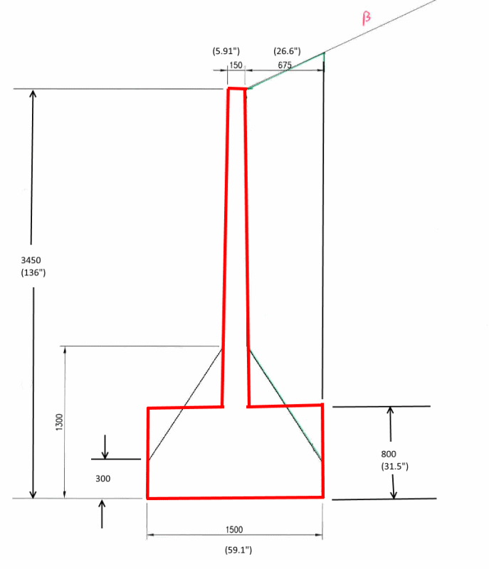

RE: Freestanding grain bins - sliding failure
Model of the wall attached. As mentioned these are designed to be 'portable' - lifted by forklifts and placed on concrete wherever necessary. Thank you for the link, SRE, I have had a quick read, however this seems to discuss cylindrical loading moreso than my situation (a "retaining wall").
The angles in the drawing are as follows:
β - angle of backfill - 25°
ϕgrain - angle of repose of grain - 30°
α - slope of proposed retaining surface - I've simplified this as a line from the base to the top to get a uniform angle of 101°
δ - angle of resultant force - 24.5°
Ka - as per page 9 of this publication: http://www.civil.utah.edu/~bartlett/CVEEN6920/Earth%20Pressure%20Theory.pdf - 0.675
The resultant force therefore acting at δ is 49.6 kN per metre (=0.5*H2*Ka*12) where grain density is 12 kN/m3 and height is 3.5 m.
Resolving this into horizontal and vertical components gives me 40.4 kN per metre horizontal and 28.8 kN per metre vertical. Using a factor of 1.25 on this and a factor of 0.8 on the weight counteracting, it would be:
1.25 x 40.4 = 0.8 x [(Mblock + Wsoil) x μ]
Where Wsoil is the amount of soil I'm willing to assume aids in vertical mass and μ is the coefficient of friction between concrete and concrete - I've taken 0.4 as my limit.
I hope that can clarify my problem enough.

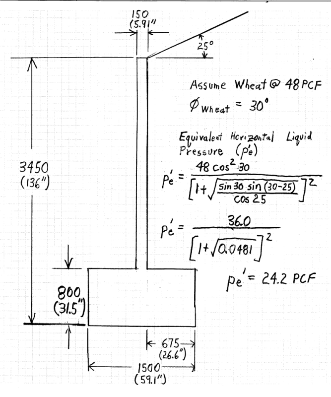

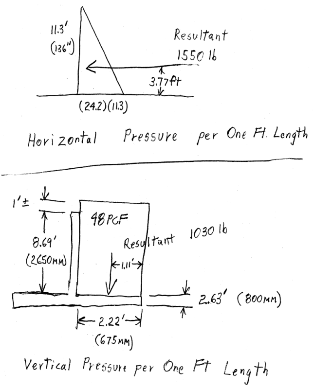

LandyEng - Thanks, now I understand where how the "vertical weight of grain" applies.
I've never been good at developing equations, so have taken the following steps:
1. Made some estimates of missing dimensions.
2. Transformed the partition's geometry into an approximate equivalent with only vertical and horizontal surfaces.
3. Assumed a unit weight for the grain (per AISC, bulk wheat @ 48 PCF).
4. Metric and I don't get along, so have made the conversion and calculated forces using numbers.
5. Used Rankine-Coulomb Equivalent Horizontal Fluid Pressure for an inclined bank. See pages 5 and 6 of US Steel Steel Sheet Piling Extracts on my website.
Here are my assumptions and calcs. Have also attached the same pages in .pdf format.
Thank you for the link and detailed response. I've gone through (and even attempted to use imperial) but I'm still getting caught in a similar position. The theory in your extract gives me a final horizontal force of 37.1kN per metre (2545 pounds per foot)
Using a coefficient of friction of 0.4 and solving as follows:
37.1 = μ (Mvert)
Therefore the total vertical mass to resist 37.1kN per metre of sliding must be 37.1/0.4 = 92.8kN per metre
If I perhaps conservatively assume the vertical mass of soil to be 0.675m x 3.5m x 12kN/m3 x 1m = 28.4kN per metre
The block then has to weigh 92.8 - 28.4 kN per metre ===> 6.55 tonnes per metre of block
This isn't even using any factors of safety - I had been trying with 1.25 x 37.1 and 0.8 x Mvert. Working this through gave 11.6 tonnes per metre, way way way over what others have supposedly proven (3.85 tonnes per metre).
I have hand calcs of my steps above however won't have access to a scanner until tomorrow. Am I missing something with my analysis of sliding?
LandyEng - I worked with the numbers, too. Concur that sliding is a problem. IMHO, the design dimensions are out of proportion. It does not have enough "heel" compared to the the height of the stem. A longer heal would give more total load (from the weight of the grain) for the friction force. Also, this would allow the concrete weigh to be lower. The design seems heavy for forklifts... 2580 lb/ft by my calcs.
