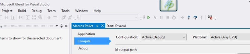

I like your idea about this thread. You are right Catia is all about scripting. So let's start with toolbar.
Small main window that appears at desktop top centre.
and expanded windows
Currently converting all of my apps to VB.net (WPF)

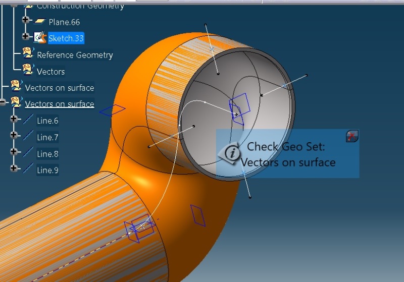

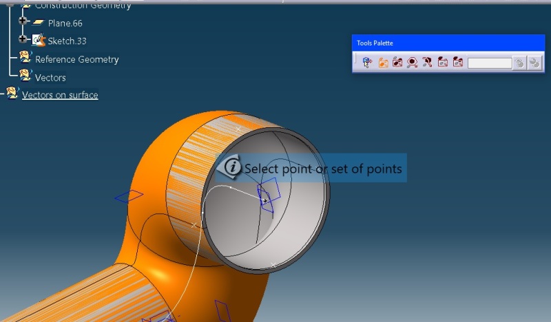

Absolutely love WPF windows. Don't remember if it's possible to set opacity on WinForms. Windows instead of message boxes
Wery well known script adopted to own needs.
Instead of messages at the left bottom corner of Catia V5 window I run such windows so user always know what app wants him to select.

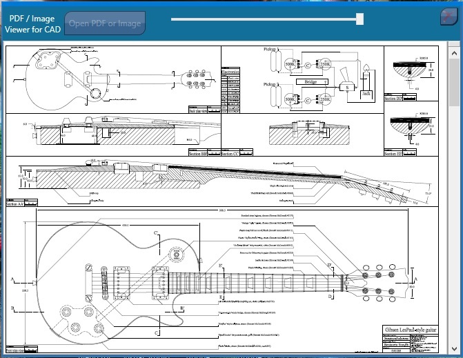

Guys any ideas how to keep window on top but to send it back (deactivate)? I want to use this for images tracing in Catia.
When mouse moves thru my application window this deactivates Catia window and I want the exact opposite of that (Catia window/application to be always active)
I use web browser control to open pdf/image files.

Just passing the mouse over it?
Test me.hide

RE: CATIA developed macros or Apps
Hello,
You could use WinApi to set CATIA as the parent of your window.
Something like this.
CODE -->
Private Declare Function SetParent Lib "user32" (ByVal hWndChild As IntPtr, ByVal hWndNewParent As IntPtr) As Integer
Private Sub SetMyParent()
        Dim myProcess As Process() = Process.GetProcessesByName("CNEXT")
        Dim p As Process
        Dim CATIA_Handle As Integer = 0
        For Each p In myProcess
            CATIA_Handle = p.MainWindowHandle.ToInt32
        Next
        SetParent(Me.Handle, CATIA_Handle)
End Sub
