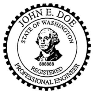

Speaking of, I made my own WA stamp digital image this morning. Surprisingly easy, even with curved text to mess with. I have a physical stamp that I could have scanned but I find that terribly inelegant. Hopefully I'm not violating any rules by doing my own digital doctoring. Frankly, I don't know how else to procure a digital image. I'm dying to show off my handiwork but that would be too much of a compromise to my cherished anonymity.
RE: Acceptability of Printed Digitally Stamped Drawings (WA State in Particular)
Quote (KootK)
cherished anonymity
We know who you are and they authorities are on to you smile
Nice art work - did you do this within Bluebeam Revu?
Well, that is just the recommended image from Washington's web page. I shoulda made a dummy edit at the same time for anonymous sharing and evaluation. Too much work now. It was mostly Bluebeam. Also Word, Snipping Tool, and an online thing that's especially good at removing background pixels. I found that one of the keys to it is use dark grey text rather than pure black. I also go in and lighten/delete a few pixels around the edges of the text. Makes for an nice, well worn look.
I did make one serious error though. I put a lot of effort into a nice, background free signature a while back. It's built into all of my stamps now. Trouble is it's green pen. Not sure why I did that. Shoulda been blue for legality. You'd think that would be an easy edit but it hasn't been.
