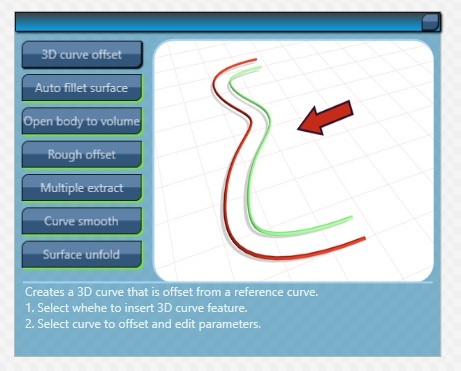

Tiago thanks for the suggestion. I don't need any messages in my applications because I know exactly how it works. When it comes to users it's like what the heck do I have to do. That is why I add images, explanations or whatever during program run.
RE: Catia V5 windows arrangement
Amazing. By the way, really nice interface
Tiago Figueiredo
Tooling Engineer
Completely switched to WPF.
