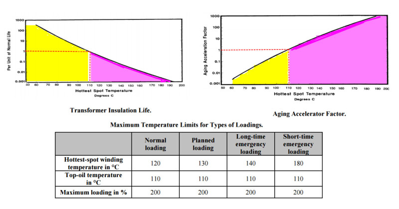

Power transformers are rated as follow:
• Average ambient temperature ≤ 30° C (86° F) in a 24-hour period.
• Maximum ambient temperature of 40° C (104° F).
• Average winding rise ≤65° C (149° F) at rated load, voltage (V), and frequency (Hz).
• Maximum hottest-spot winding temperature ≤80° C (176° F) above ambient.
Notice that 14 MVA can be achieved if the average temperature in 24 hrs is ~14oC (~57 oF)
Below is an illustration of the impact of exceeding the rated values on the transformer Insulation life expectancy and accelerated aging effect.
