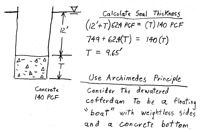

TheRick109 - Sorry, I did not intend to confuse the situation. I don't use "submerged weight" for calcs, but account for it by using Archimedes' Principle.
The key fact is the seal concrete is below the water table and is buoyed by it. There is no way around this.
Archimedes Principle is easier to illustrate than to put into words. Here is the diagram posted in response to another member's question on this same subject:
No matter which way you perform the calcs, submerged weight or Archimedes's Principle, for the 12' depth a safe cofferdam requires a seal that is a minimum of 9.6' thick plus a safety factor. The safety factor can be additional concrete thickness, reliable concrete-to-HP bonding, or a combination of the two.
This subject is important, keep working with it or asking questions as needed.

RE: Tremie concrete to steel pile bonding strength
Edit:
Ok, I see you are using the submerged weight of concrete (77.6 PCF). In that case I agree with the math for D = 14.5' for concrete only and D = 6.57' for concrete plus concrete-to-HP bond strength.
Even so, I would not go with a seal less than 10' thick... and that takes credit for a certain amount of bond strength.
