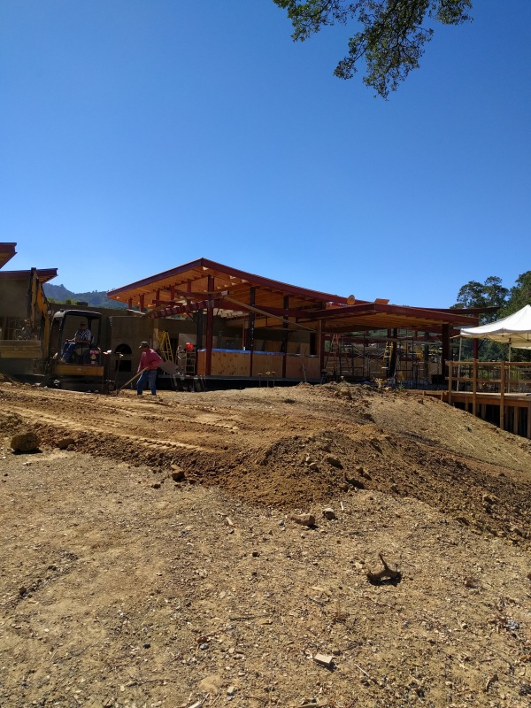

Different project, but this is the effect they are going for.
RE: Barrel Framed Roof Joists
It's gorgeous. Your climate permits some sexy detailing that would never fly in colder locales. Nice glass too.
