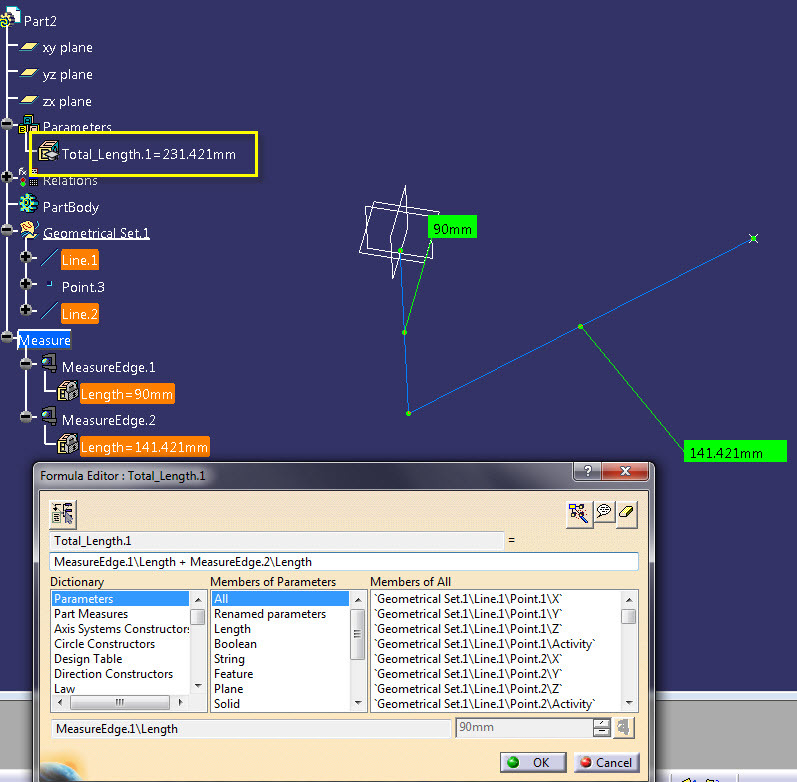

Is it possible to get automatically the total result of the dimension shown in the picture below?
Thanks!

Well, you know, there are different ways to solve this problem.
1. For your part (which by the way is not a bundle), you can select and keep measure and get those measurement and make a sum with a macro for all of them
2. You can select one by one the element in 3D and make a sum by adding one by one
3. You can extract in an excel file the specific named parameter (which in your case is length in Measurements) and do the sum there.
4. You can extract element in a specific geo set and do a join and measure the join but is not the case for your part, you don't have continuity for your edges, but it would be the case for the bundle if I remember correctly.
These are just few cases how the problem can be solved. I think is enough to show everyone how good it is to give as more details as you can to someone who is programming a macro smile .

RE: Measure Item - Total sum
Thank you Fernando! (The CATPart I created was designed for the measurement reason only; I haven't included any bundle, for the reason of simplicity).

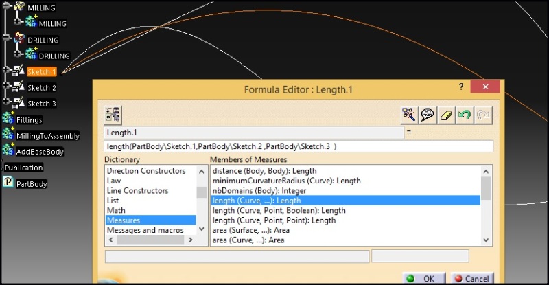

Easier than that:
Creat a lenght parameter, and then add a formula to that parameter.
length(PartBody\Sketch.1,PartBody\Sketch.2 ,PartBody\Sketch.3 ) . You can pick the curves that defines the lenght that you want, but assure that they are spaced by a ",".
it updates every time you make changes to the curves.
