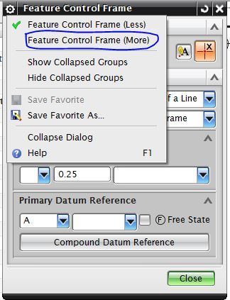

Add secondary datum to Feature Control Frame NX9
RE: Add secondary datum to Feature Control Frame NX9
Make sure you have selected highlighted option(Blue) in dialog option

Ranjith thank you! I can't believe I couldn't see that!
