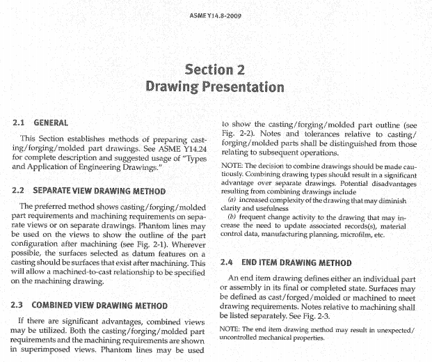

(o) - Dimensions and Tolerances apply only at the drawing level where they are specified. A dimension specified for a given feature on one level of drawing is not mandatory for that feature at any other level.
Example: I have a machined casting that has many as-cast surfaces remaining on it. These as-cast surfaces are important for proper part function. Based upon fundamental rule (o) I need to put these casting dimensions on the machined part drawing or they can be modified during machining and the machined part is acceptable even though the important as-cast surfaces have been detrimentally changed. That is how I read fundamental rule (o).
How do people handle this situation? Do you actually put all remaining as-cast surface dimensions on the machined part print (in duplication of what is already on the casting drawing), making the machined part drawing extremely complicated to read? Or, do you put a note stating that as-cast surfaces are not to be modified from the casting print during machining?

AndrewTT - I think you are misunderstanding thing.
You don't normally repeat dimensions on subsequent drawing levels except for reference or things like datum targets etc.
In your example of a machining drawing for a casting - they are only to do the machining required to meet the machining drawing requirements. They should not be arbitrarily machining or otherwise modifying other features etc.
You normally only dimension the features at the level they are created (and as required inspected).
These features are then only modified at subsequent levels if you are explicitly told to do so.
"Or, do you put a note stating that as-cast surfaces are not to be modified from the casting print during machining?"
Is hence not required.

It's common to supply the casting drawing, for reference, to shops machining them. It's not mandatory, but it sure is helpful. For reference only.
I have always worked, and dictated work be done, similar to KENAT's clarification. The machined-part-drawing is specifying the "scope of work" which is not only what the machine shop /shall do/ but also limits them to do /only these things/ unless authorization is approved (such as tooling holes/features for setup/fixturing that do not inhibit part function)

It's the tricky thing - viewing the drawing as manufacturing instructions versus the drawing as documenting inspection acceptance requirements.
If viewed as the former, then there is no way to account for part deformation due to material removal. One cannot add a requirement to the machining drawing that will check to see that as-cast (for example) features remain unchanged within the original tolerances. Instead, the out-of-tolerance condition will not be detected until after the part is put into production and might end up in delivered products, potentially requiring a recall, possibly doing great harm.
As an inspection document, the machinist will review the drawing, do only the work required, and the inspector will verify the part meets all the requirements on the drawing. If the part fails on a feature the machinist doesn't affect, then the part does not enter the supply chain. Instead the engineering team is called in to determine why the feature that passed at the casting supplier no longer does. The result may be that the casting needs to be stress relieved or it could be that the machinist needs to not bend the part in a fixture (I've seen both.)**
What makes the processing of castings difficult is that, against the advice of the standard, the casting drawings are used to specify the manufacturing method. "The drawing should define a part without specifying manufacturing methods."
Essentially, there should not be a separate casting drawing; only a finished part drawing that might include sloped surfaces and mismatches that accommodate the process or just have really large profile tolerances.
However this is inconvenient for purchasing because they can't find a cast/machining supplier and so it becomes an engineering problem to solve the contracts issue.
To turn this another way - if an engineer wants to use an off-the-shelf part that happens to be cast and then machined and needs to ensure that it will fit, do they create two envelope drawings or just one that encompasses all the surfaces, as-cast and machined alike?
** The best/stupidest was when a part was being probed for compliance on the CNC machine and it passed, but then could not be assembled because the fixture put so much load on the part it twisted. When it was removed from the fixture it twisted back to it's original, free-state shape. I guess if the assemblers could use a 30 foot prybar they might have gotten it installed; who knows.

Quote (3DDave)
Couldn't the following symbol be used on the machining drawing and applied to the surfaces that must remain unchanged within the original tolerances?
Quote (3DDave)
Not saying this is incorrect, but seems like in contradiction to what's been stated in section 2 of Y14.8-2009.

pmarc - the part you took out of context is based on my observation of the typical argument that dimensions and tolerances should not be duplicated from the casting to the machining, not that it's impossible to tell the machinist to leave a surface alone. Even if the machining doesn't carve into a surface, that doesn't prevent the part from warping due to relief of internal stress or because of over-enthusiastic clamping.
'14.8 is dedicated to the concept of supporting purchasing convenience, so it is obviously not going to say 'don't make drawings per this standard' even though it could be entirely absorbed as a chapter of special application into Y14.5. The 'don't machine this' should be in the main standard and used to apply to purchased parts that are modified, rather than being trapped in a casting standard.

We do quite a lot of machined casting drawings, and from my experience the approach preferred by Y14.8 is not only for purchasing convenience.
FYI: I didn't take the 'don't machine this' symbol from the casting standard - it is in Y14.36 for surface texture symbols. But in general, I agree some of the concepts/techniques shown in Y14.8 probably should be absorbed by Y14.5 - just like the movable datum target symbol was in 2009.

Those definitions seem to leave casting drawings as semi-processed (manufacturing process) drawings. It seems the context of 'for such items' is items that are made from raw, or bulk, or semiprocessed items, not the items themselves, as a contrast to altered item, selected item, and modification drawings that apply to items that are not made from things on that list.

I guess different people/organizations prefer different approaches depending on circumstances. In the company I work for there are at least a couple reasons why casting and machined casting drawings are done as separate documents. These include, but are not limited to, the following:
- different suppliers make castings and machined castings for us;
- in many cases, either casting or machined casting drawing contains information that shall not be available for the other supplier (one of the reasons is key technology control);
- castings have very specific quality requirements that can be examined only when the part is in as-cast condition;
- with the use of end item drawing approach, there is no robust way to control stock allowance for surfaces that are subsequently machined off. This may lead to unexpected mechanical properties of the end item (as stated in para. 4.2 in Y14.8) - for example when the stock allowance is close to absolute minimum. This may also lead to machining cost increase - if the stock allowance is too generous much more material needs to be machined off (cycle time increase, etc.).
In general, I agree that the drawing should specify the end product without breaking it down into manufacturing steps. However - as stated in the fundamental rule 1.4(e) in Y14.5-2009 - there may be exceptions to that. People way too often like to read only first two sentences of that paragraph without digesting what the rest of the paragraph is about. In my opinion, there is enough reasons to say that separate casting drawings provide information that "is essential to the definition of engineering requirements".
