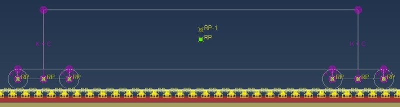

I'm doing a dynamic analysis, in which the only load is the gravitational load and the train, which is a rigid body made of a number of masses:
the mass of the wheels, the mass of the bogie and the mass of the vehicle, is moving at a constant speed.

Does exist a way to apply the gravitational load only to the train (and then to the masses belonging to the train)?
I've tried to do that, but it does not consider the masses: and then the load is zero.

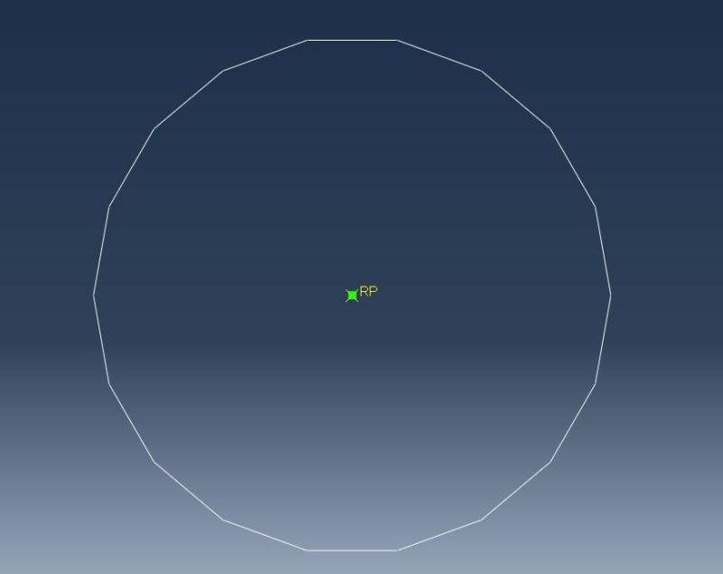

The masses are linked to reference points. For example below is the part of the wheel:
The fact is that if I assign the gravity load only to the reference points I've got the error: "A gravity region may not contain reference points".

RE: How to assign the gravitational load only to point masses
I think it is not supported in A/CAE, since gravity has to be applied on elements. The point mass will become a mass element when you write out the .inp. So there you can add the gravity to the mass element only. I've tested it on an simple example and it worked.
