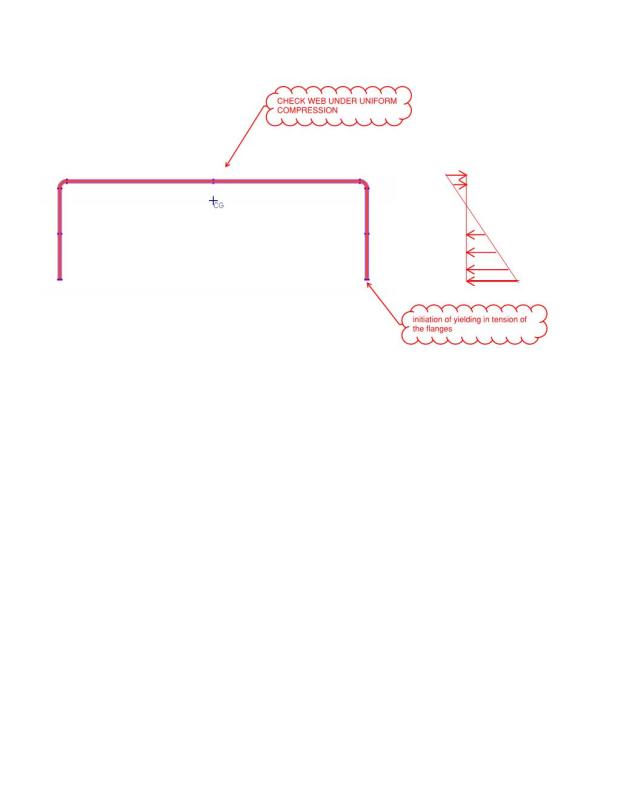

I am designing a building where we are utilizing the Ecospan composite floor system as our main floor framing system.
http://ecospan-usa.com/
This system will be bear on metal studs that are assumed to be spaced at 16"oc. As I understand the system, if studs and joists are not aligned in direct bearing, the top track must be designed for the pre-composite load of the floor system delivered to the track, before the load distribution member develops the ability to distribute load.
This is where I get a little lost in the cold form design process. Using the AISI 2012 specification I first check section C3.1.1 for flexural strength of the track. Seems pretty easy following procedure 1 - based on the initiation of yielding, basic M.n=(Section Modulus * Fy) stuff.
Then, am I also required to check individual elements of the track per section B2 of the specification? Specifically, the top of the track will be in compression which I am picturing as an element in uniform compression stiffened on both edges. The equations in in this section look pretty convoluted and I did not know if purely checking section C3 was sufficient to say that the track can resist the moment. Because the initial yielding is in tension, I need to calculate the effective section of the track, which upon looking up examples of calculating effective sections, looks very complicated too me.
Also, if this section B2 does apply, is there any software that can aide in these calculations? I have a good amount of software available to me, but none of the more general packages seem to have any good CFS design checks (SAP RAM Risa).
Thanks in advance for the help.

for my money, I would not check the web as a panel in compression.
I think you need to determine how much of the web is effective; I'd start with 30t, there's an iterative procedure to check this ...
assume an effective width,
calculate the stress in the web,
calculate the critical compression stress for the web,
adjust initial assumption as required.

rb1957, I am new to CFS design and was wondering why I even need to calculate how much effectiveness there is in the web? Is it assumed that the stiffest part of the web (i.e. where the flanges stiffen the element) will only take the compressive load?
Do you often find these element checks to control the design of members? Or does the member check typically govern the design of cold form members?
Thanks for your post BSVBD. I have design example calculations from a CFS designer that "proves" that a beefy track (600T350-68) can take the point load from a joist. They simply follow the flexural component checks found in C3.1.1 and calculate a minimum section modulus required. They do not perform any element checks as I described above. I want to make sure they have checked everything as well, as like you said, sitting a joist on little track does not intuitively feel OK.

the "web" is the flat bit between the flanges, as you've labelled. It may not be fully effective, depending on geometry. I picked up on your use of "effective section" and figured this is what you meant. If the compression from bending is less than the buckling allowable then you're GTG.
If it were my beam, and it's principally loaded in bending, I'd form lips at the ends of the flanges.
Looking at the video they seemed to be laying a concrete floor on a continuous corrugated panel. How does your open section fit into this ?

In terms of evaluating local buckling, I think that the critical scenario will be over top of studs when the track flanges are in compression. Folks debate this and some just treat the track as simple spanning, assuming that the flanges will just buckle out of the way. I question how much shear capacity you have once the flanges buckle. It's also possible that positive moment in an end span condition may govern.
