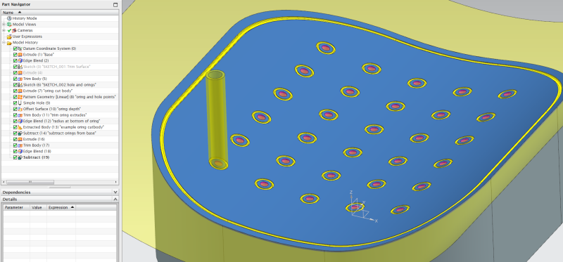

Greetings:
I have a vacuum fixture that I am designing and need to put a .125 dia x .09 deep groove around a set of holes in my mandrel in order to place a rubber gasket to seal the vacuum. I do not know how to model this groove in this unique contour. Can anyone give me some ideas on how to accomplish this? I have attached a picture of the mandrel, the holes highlighted are the holes that I need a perimeter groove around.
Thanks in advance for any assistance.
Brent

The first thing I'd try:
  • create a sketch in the size/shape you need around the holes
  • project the sketch curves to the faces of your model
  • use the projected curves to create a tube feature of the appropriate size
  • subtract the tube from your model
This will leave you with a groove that follows the contour of your model, easily updated by editing the sketch.

Cowski,
I did the project geometry and tube feature. It worked as that feature does. My question now is, when I create that tube, I now have a groove that is .134 wide x .065 deep. I really need the depth to be .134 as well. Can you help me get that result? Would that be a function other than the tube function?
Thanks again, I attached an image of the cross section for an example of what I just performed.
Brent

Alternative 1: you can create the cross section that you need then use "swept" or "sweep along guide", using the projected curves as the guide string.
Alternative 2: edit your sketch to create the inside/outside perimeter of your desired groove, extrude the sketch toward your part, use "trim body" to trim the extrude back to the face(s), use "offset face" on the trimmed extrude to create the groove depth, subtract the extrude from your part, and finally blend the corners of the resulting rectangular groove to round it out.

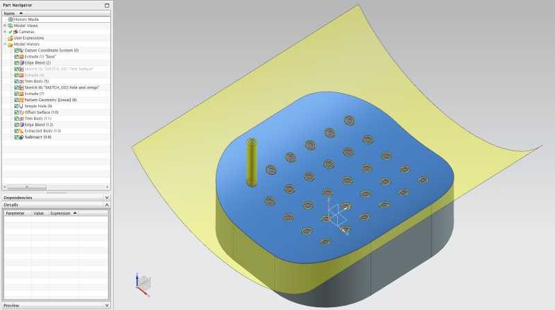

RE: Contour Modeling Question
Here's how I blindly went about it....some different methods of getting same results.
t300master is correct, variational sweep is definitely the way to go for longer grooves as it is accurate and gives the most control over the profile.
Anyways worked a bit more on the part, mainly to try out variational sweep and the difference between o-rings extruded along the o-ring's center surface normal, variational sweep and o-rings created by thicken which should give sidewalls such that the sidewalls always follow the surface normal.
Yes I agree, also the variational sweep (at least as I modeled it) will only follow the surface normal along the path curve, which means that there is an error in depth towards the sidewalls. Thought this could easily enough be corrected by trimming with an offset surface as in the extruded/tube example.
