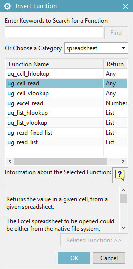

Q1, Maybe the the ug_cell_read formula is able to answer your problem in Tools/expression

ug_cell_read() is for reading specific cells from an excel sheet and cannot read notes, tables etc from drafting as those are different entities.
