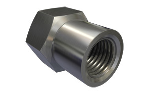

I have a situation where a contractor has cut off part of an anchor rod so that there is not enough thread length to attach the nut on top of the baseplate. The rod in question is F1554 GR. 36 steel.
I'm aware that sometimes people will weld nuts to the bolt/rod, has anyone here done a repair like this before or does anyone know if there is any actual standard anywhere that sets out guidelines for this kind of thing?

Maybe try Elcone nuts: Link
RE: Welding Nut to Anchor Rod?
Try a coupling nut, used to fasten two threaded rods together.
It is not recommended because the anchor rod and nut are different grades of steel and are made using different treatment processes. The result is that the anchor rod and nut will each cool at different rates which leads to high localized stresses and increases the chance of thermal cracking. Have had success with Elcone nuts as suggested above.

What loads are being applied to the rod? Is there an uplift concern?
If the loads are not extreme, or if there are other rod anchors that can resist the applied loads, I've specified to weld the rod, all around, directly to the base plate.
Or drill another hole(s) through the baseplate and specify post-installed anchors.
