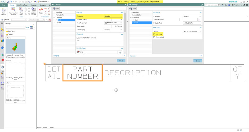

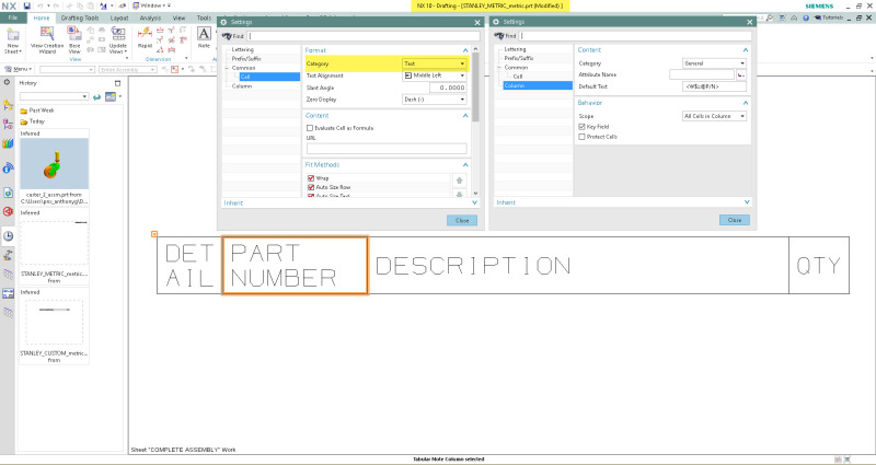

RE: BOM Sorting Order
I didn't have time to test my theory, but the difference I see between the two parts lists (see images below) is that your part number column in the original is of type 'text' whereas the custom is 'number'.
That to me is the cause of the issue for the way it will evaluate the contents for sorting.
Also, not really a big deal, but I would only ever have one key field for a parts list (your custom one is correct on that, the original isn't).
I would normally use the Part Number, but description will work as well. The key field is what is used as the way of establishing the quantities of parts.
So any attribute value in a key field column that is the same will be combined for quantity. So I would always recommend using the column that is unique to individual parts (P/N or Description are the usual ones).
Anthony Galante
Senior Support Engineer
NX3 to NX11 with almost every MR (24versions)
