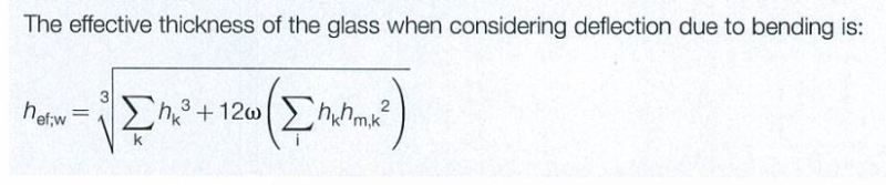

Anyone have any experience with design Tempered Laminated Glass that is 3 lites thick with 2 layers of PVB in-between?
E1300 Section 6.2.5 has it for singly glazed LG, but my situation seems a little different. Do i just distribute the load?
Thanks in advance.
RE: Glass Calculation - Laminated: 3 lites Fully Tempered, 2 layers PVB
For high temperatures and long duration loads, you'll probably treat it as three non-composite lites. For other conditions and composite behavior, from the IStructE document:
What is the intended use of the panel? Three laminated is unusual so I'm guessing it's something like floor. Depending on the use, it may be wise to consider one or more layers to be sacrificial or non-participating for reasons of redundancy, fire performance, etc.

Yes, its for a Canopy , and it seems like its overkill. 1/4"FT-1/8"PVB-1/4"FT-1/8"PVB-1/2"FT

As KootK said...you can treat it as 3 single lites ... load share according to the stiffness of each lite
it is a pretty thick glass ( 1 inch in total )... so I guess the deformation might govern the design
