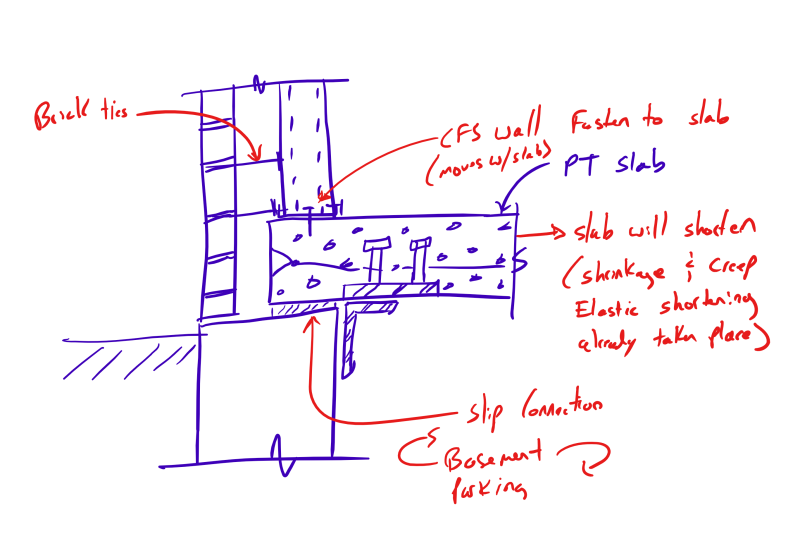

A muliti-story building (say 3-4 stories) w/ a basement for Parking. The construction is PT-Slabs supported by concrete columns and shear walls. To reduce RTS cracking at the first floor but still support the walls for out of plane forces we have released the slab as shown below.
Questions:
1. In the section below what are your thoughts on having issues with the CFS framing moving with the slab and causing issues with the brick? Supposedly the cladding would be installed about 2 months after this floor is constructed. I'm tempted to say this will be ok...

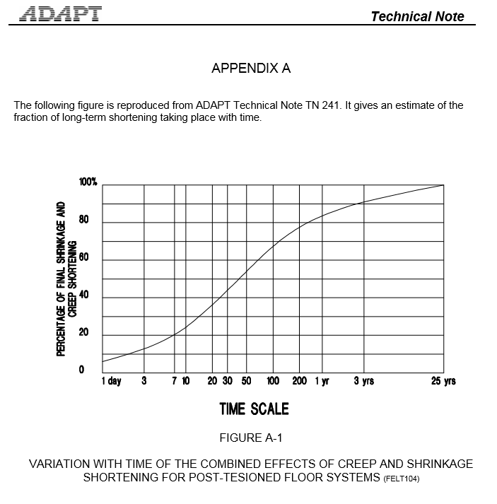

2. Does this chart from ADAPT seem right for the amount of shortening that will occur at 60 days?

RE: PT Slabs - Restaint to Shortening Cracks and Forces
1) Is there not some mechanism that, at some point, locks the relative displacement between the slab and the foundation wall? Are you delivering shear to the wall through the angle in a way that allows relative out of plane movement to occur?
In theory, soil pressure will cause your wall to move inwards with the slab edge so no relative displacement. That'll be less true at building corners etc however.
2) I don't have any basis for comparison really.
Quote (Kootk)
No, nothing ties them together. The angle is there to resist the horizontal reaction at the top of wall.
Quote (KootK)
That is a good point. The would construct the wall, construction the slab, backfill the behind the wall. So some shrinkage and elastic shortening will have occurred by then. However, there still would be some further shortening and thus some wall rotation. Maybe this just happens to be in an acceptable range so that everything is moving together.
Quote (RF)
So how do you get main floor slab diaphragm shear out into the basement wall?

I think I said this wrong. Lets ignore the foundation moving due to lateral earth pressure. I was thinking that the first floor foundation wall would stay where it is. The second floor would move inward due to shortening, thus pulling the CFS and masonry along with it. So you would have the same displacement but 10' between points of displacement. Now considering that he wall may move due to earth pressure...Maybe all is well, sorta.
Ah, I get it now. I would not expect the system to be that sensitive to that type of movement. Again though, corners are probably the trouble spots where you'up up against perpendicular brick.
Quote (KootK)
Well ideally you dump it into shear walls which are located near the center of the diaphragm. In the real world I am forced to use only as many dowels as needed near the center of the walls (away from the corners of the building). Where the wall is more flexible.

RFreund,
Have you calculated how much shortening you expect in this slab? In both directions? Remember to allow for temperature change as well as shrinkage. They are the 2 main effects. Creep and elastic shortening will be less. Temperature may be hard to estimate as it depends on the location, time of year and temperature at time of pour. Can your wall ties take that movement?
Edge walls are normally released like this to alleviate restraint effects in the slab parallel to the wall rather than perpendicular. Unless the wall below is very short, it will not provide a lot of restraint to the slab perpendicular to the wall, and soil pressure over time may actually put the slab into compression perpendicular to the wall if there is a connection to the slab.
Tying the CFS wall to the top of the slab is still going to provide restraint in the slab parallel to the wall!
Is your basement wall cantilevering, or does it need to be propped for retaining action? Normally it would be propped by the slab after the slab is poured and connected (possibly using a delay strip around the boundary) where I come from.
My preference has always been to spend my money to provide crack control reinforcement in the slab rather than trying to release it. If you fail with your releases, you are stuffed.
The retaining wall will be cheaper as it is propped. And as I have said many times on this site (to the point where people are probably sick of it) prestressed slabs have really good crack control : until they crack. Then the crack control is terrible. This is especially so with unbounded PT and even worse with banded/distributed tendon systems. Hence my preference to do something we know works which is to provide sufficient bonded reinforcement to provide good crack control, and that requires more than the normal T&S minimum reinforcement as the normal figure in the code is for an unrestrained slab or very nominal (read as none according to some more knowledgeable than me) crack control in a restrained slab.
It is propped. We originally had the delay strip detail but it was fought against (of course). I think b/c the GC wasn't used to dealing with these issues. With some explanation they have come around since and we may go back to this detail.
So what is propping the wall? The slab cannot with that detail.
You can calculate the shrinkage shortening from ACI209. It will be around 1 - 1.5" in the 200' direction total but will depend on concrete mix, environment and especially slab thickness.
Temperature will depend on conditions but will be a little less than 1" in that direction probably.
Axial shortening about .1".
Creep .2-.3".
Adds up to a lot! About 2 - 3" total so 1 - 1.5" or so from each end.
