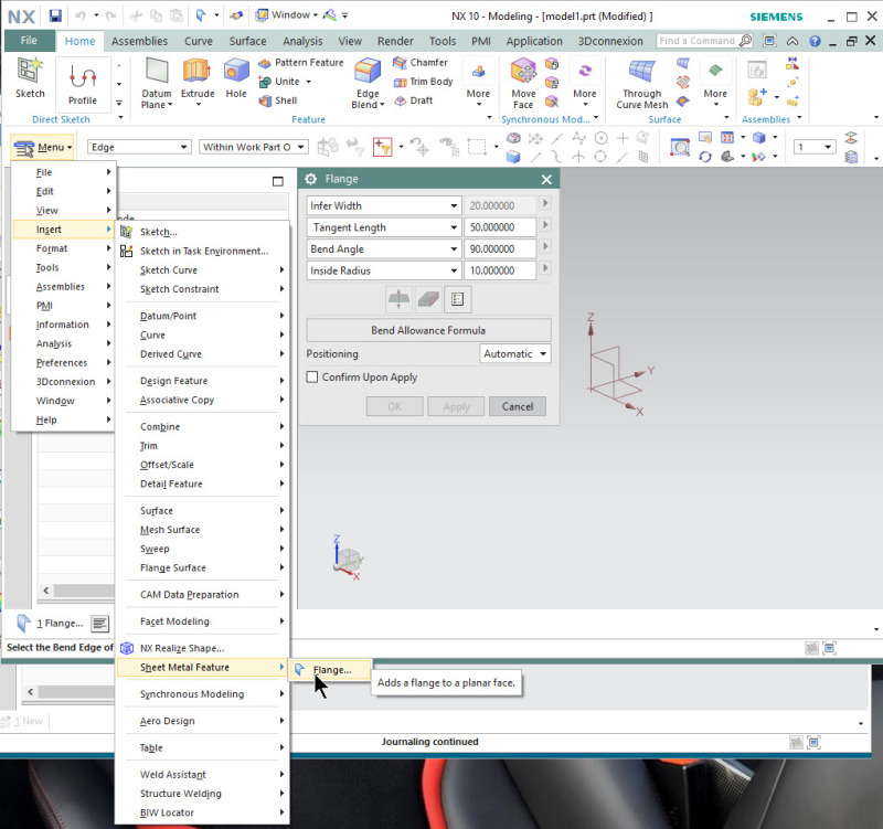

RE: Deleted commands in between NX 8.5, 9.0 and 10?
Hi Tomas,
I know the env variable that allow to activate in modeling the retired function "flange", but it doesn't work anymore in NX11: Any Idea ?
Regards
Didier Psaltopoulos
http://www.psi-cad.fr
No, i did not know that the Old-flange had an environment variable. - What was so unique about the old flange that made it have a system variable ?
The Old- form/unform ( flat pattern feature ) was a little quirky, but it did flatten everything.
