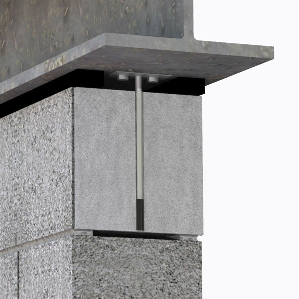

More than once now I've gotten complaints from contractors on the use of PTA's attached to the bottom flange of a steel beam. Their argument is that once the masonry gets up to the beam its not possible to grout the bond beam course immediately below the beam due to it being blocked by the flange.
Has anyone else run into this problem and what solutions have you come up with. Thanks in advance.

The PTA can be field installed and located in the head joint of the CMU to avoid the need for grouting the top course. If there is another structural reason for the bond beam you can drop it down one course.

Yes I've had the same problem - but haven't come up with any solution. I just noticed the other day a large proportion of these omitted and the reason given was that they're a pain to install. I haven't found any solution - there are other anchors but I think for this condition they all require at least a little thought and extra effort to install.

If you contact H&B they will send you a signed and sealed calc that provides the lateral capacity. It's a one page hand calc, not much to it.

I have a similar problem when retrofitting a new foundation wall under a house. I tell them to bust out the face of the CMU and hand grout with a really stiff mix.

only seen these things once on a job. design/contractor agreed to move the 8" bond beam to the course below and grout the top solid with stiff grout. The masons would cut the center web and a slot in the end shell to make a big sideways "U" and work the block around the rebar/dowel into position then pack it with stiff grout.

"PTA" - Partition Top Anchors. Link

Do these anchors allow for vertical movement of the beam above?
Mike McCann, PE, SE (WA)
RE: CMU up to underside of beam
They come with an option of an exterior plastic sleeve with compressible bottom material inside the sleeve, to allow for steel beam vertical displacement:
