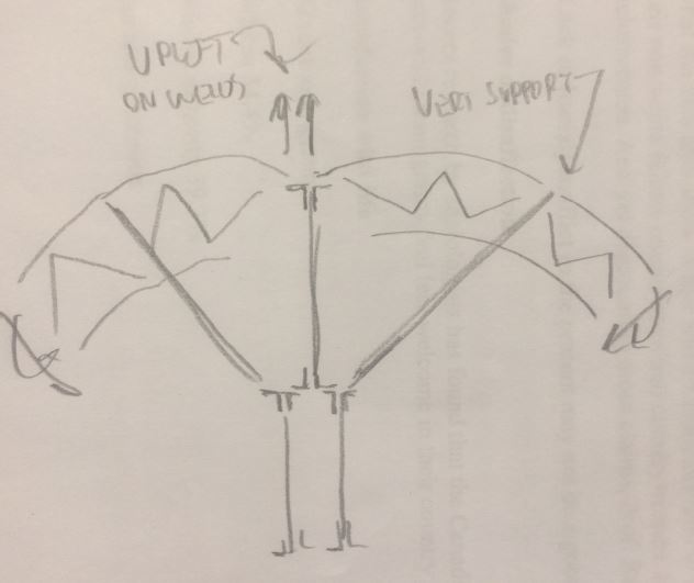

I'm leaning the other way and would prefer to grab just the column and leave a gap between the new and existing girders. I think that arrangement would be easier to fab/install. I'd also take comfort in not having messed with the behavior of the existing girder much at all. There's a fair bit of complexity and uncertainty associated with a partial, continuous bearing solution in my opinion.
Some other things to consider:
1) You could use a pair of new girders sandwiching the existing column. That would make for convenient column removal and would keep the existing girders behaving as originally intended. One could also install the new girders beside the existing girders rather than beneath them. You might get back 24" of head room if there's any value associated with that.
2) See the sketch below for another solution. It would be pretty efficient and you could dial up the pretension to grab the existing load without incurring a bunch of additional deflection. Also, it would be easy to bring into the facility in pieces I would think. Is it correct to assume that the big new girder would have to shipped as field spliced segments?

RE: Existing Column Removal
Quote (Steel PE)
but the budget has been set and unless two girders will save money they are going to want to stick with one.
Got it. The two girders may well save money:
1) Your design should be governed by deflection. As such, from a material perspective, the quantity may not change much.
2) All the effort of shimming etc may add up to something.
3) If the two girder system will eliminate a bunch of shoring etc associated with the column removal, that may be big money.

Quote (SteelPE)
I think there was a discussion on these forums a while back, but what braces the column out of the plane shown?
1) Run a brace from the roof deck to the column at the elevation of the bottom of the existing girders. Let the column cantilever down from there stability-wise OR;
2) Splay the four rods slightly as they leave the column.
3) Install a light, perpendicular cross bracing truss to connect the bottoms and tops of the two severed columns.

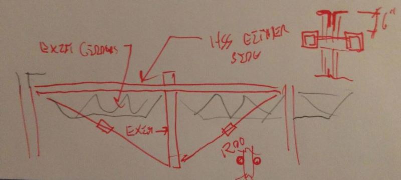

OK, so after meeting with the owner and the fabricator we have a slightly different plan of attack. The fabricator would like to sandwich the existing column between two girders and then use some channels to distribute the load in the column over to the two girders. Attached you will find a plan of the proposed stabilization of the top chord of the girders. Do you think this is adequate bracing for these? From my prospective I don't think the top chord of the girders could possibly move horizontally.
You've got the top chord of the girder braced but I don't love the moment connections that you've created at the ends of the existing joists. They'll hang up on the braces for future loads. That's one of the reasons that I favor raising the new girders up beside the existing girder and trying to tie the top chords of the new and existing systems together laterally. Similar to the details that JAE posted.
Kootk,
There isn't enough space to slide the girder up that high plus we have to deal the rerouting some roof drains. The idea the fabricator came up with had me placing the TC of the girder at the bottom of the existing joist. The issue I have with that is the existing joist girders slope causing conflicts with the bracing for the new girders.
And I don't see adding the kickers which are only attached to the top chord of the existing joists causing a "moment connection" in the joist. The idea is to apply the kickers in-between the existing joist and then use a L5x5 to take the stabilization forces back to the joist. This way 4 joists shard this stabilization force not 2, and we have something good to weld to.

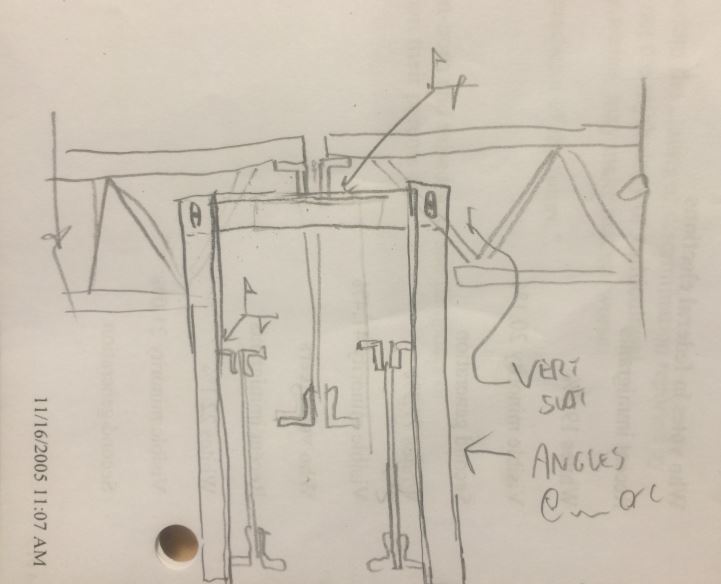

Quote (SteelPE)
Got it.
Quote (SteelPE)
Not sure I get how the slope impacts the bracing. Can you elaborate? Regardless, if you're just picking up the column, as I'd recommend, the slope shouldn't cause any issues that can think of.
How are you handling bottom chord bracing for the new girders? Running the bottom chords out to the columns and tying in laterally with slots?
Quote (SteelPE)
See sketches below for the problem, to the extent that there is one, and a cost neutral improvement (in my opinion). The 5x5 introduces some beneficial flexibility, I agree.
The bottom chord bracing issue is more of a filed issue but I will try to briefly explain. The existing girders are 40' long and sloping 1/4"/foot. If we place the top chord of the new girder 10" above the bottom chord of the existing girder there will become a point where I can't get the angle in I show on the top chord of the two girders (if the new girder has parallel chords). This length will be pretty significant as the slopes are slight, therefore we would need to create multiple details for the TC bracing. We could eliminate this problem if we slope the top chord of the new girders to match the existing slope of the roof (1/4"/foot).
How am I going to handle the bracing of the BC of the new girder, the same way they joist manufacturer would normal do this, brace it back to the TC of the joists. Actually haven't given it much thought as the manufacturer typically handles this. I might put a feeler out to them if the is the direction that we go.
Interesting sketch. I will give it some thought, not sure I like the vertical slots (although I know why they are there).

Ah. Is it at least a single slope? Or does one existing girder slope up and the other down? Some options:
1) My proposed detail eliminates the issue.
2) Use a pair of mated, long leg angles back to back to form a zee shape. Adjustable.
Quote (SteelPE)
That sounds like quite the forest of long bracing angles. Some alternatives that the joist supplier may be able to help with:
1) My detail eliminates this issue also as the bottom chord is also effectively braced.
2) Internally cross brace the two new girders.
3) Make the girder botttom chords laterally stiff enough that they can span between columns without bracing.
4) Make the bottom chords heavy enough that they're self stabilizing without any help.
I'd look into supporting the column at the bottom of the new girders. You're inherently more stable that way.
KootK
I really appreciate you opinion on this. You made me go back and check the beam alternative. Upon doing so I realized the only way to do this is to use a joist girder. If I use 2-40x149 beams my total load deflection is 4 inches at 298#/foot. If I use a 2-72G girders my total load deflection is 2 inches at approx 140#/foot weight and it's easier to "grab some extra moment of inertia" with the joist girder.
I also like your idea of "supporting" the column on the bottom chord of the truss. This will give some added stability to the system.
