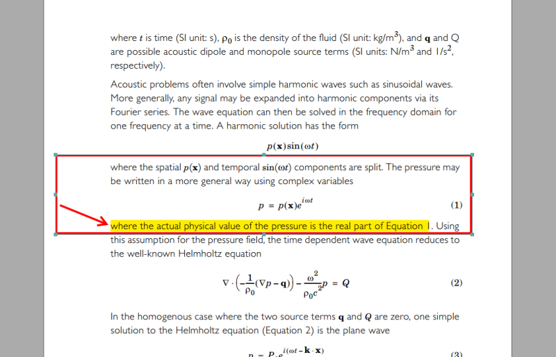

Ok...but how to interpret it then? Maybe it does not have a physical interpretation itself, but has sense only for computing the magnitude of P.
Yes, I confirmed with a simple test.
I work with lossless flow. I have a source of pressure in a closed box. If all the walls are rigid, the imaginary part is zero.
If I add impedance to a wall, that creates damping and I see a non-zero imaginary part.
Ok, thanks. What confuses me is a sentence found in a Comsol document.
I attached an image showing the sentence.
Thanks.
RE: Acoustic fundamental. Part 1: Real and complex part of Pressure
p(t) = Amplitude *Cos(omega*t) = Real Part[ Amplitude*Exp(j*omega*t)]
= Real Part[ Amplitude*Cos(omega*t)+j*Amplitude*Sin(omega*t)], courtesy of Euler....
To summarize hacksaw's answers (correct me if I am wrong):
- When working in the frequency domain (with Helmholtz equation): physical pressure is the magnitude of the pressure vector {Re,Im}
- When working in time (directly with the wave equation): physical pressure is the real part of the pressure vector {Re,Im}
