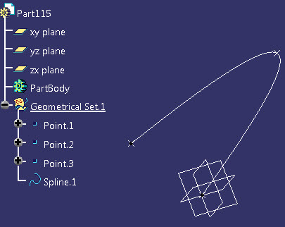

@Hadiza Hamza

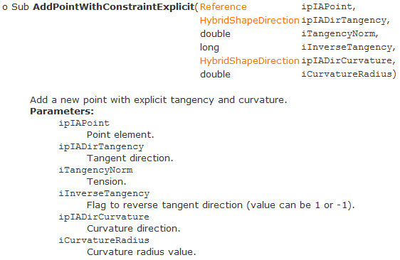

AddNewSpline() can create a 3D curve if you use non-planar points. See code below that uses 3 points to create a 3D curve (in this example I already created 3 points in a geometrical set in CATIA, but you could create them in your own script to make it fully automated).

hybridShapeSpline1.AddPointWithConstraintExplicit reference1, Nothing, -1#, 1, Nothing, 0#

hybridBody1.AppendHybridShape hybridShapeSpline1
part1.InWorkObject = hybridShapeSpline1
part1.Update
