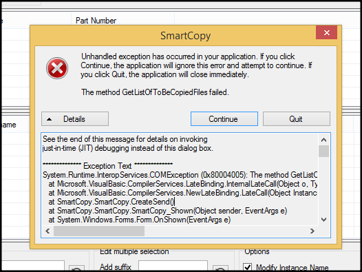

There is an error:
Tiago Figueiredo
Tooling Engineer
RE: Macro for "new from" product
What's your enviroment? OS, CATIA release? is it CATIA single installation, copied and registered or network deployment?
I've tested on a R19, network deployment and I got the same error. On a R21, single installation it worked fine.
The problem comes from SendToService object.
Please drop me a message on LinkedIn to send you the source code.

One more for you: do you have PX1 license? It seems that this is your problem.

Is it possible to keep away from licenses? Seems to be pretty useful application but PX1...I'm not able to run this app. don't know if it's because of PX1 or system (Catia V5R26, Win10). Could you please share source code? I'm not able to contact you thru LinkedIn (Have to pay for some features like messaging).
And back...
@Jenial: I have no idea why DS implemented this license check while creating the SendToService object. Interesting enough, using the SendToDirectory manually through V5 GUI does NOT prompt for PX1 license.
To summarize: automation of SendTo requires PX1. Feel free to contact your VAR and ask them: WHY!?
