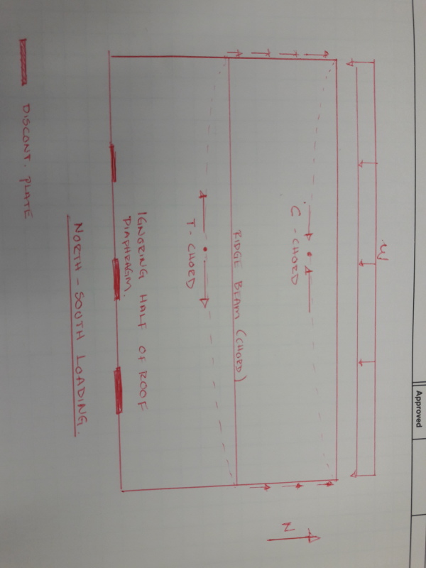

JAE, here is a sketch for the diaphragm. I see the ridge beam acting as a chord with the north to south loading. Im having difficulties when I reverse the load. It seems that half of the roof (dormer side) is cantilevered and just goes for a ride north.
Regards.
RE: Discontinuous chords in wood framed building @ dormers
Quote (OP)
Many engineers would argue that, for E-W load when the function is that of collector rather than chord, the collector does not need to be continuous as a chord does. Yet another shade of grey. What bothers me about the use of a partial diaphragm is that it can imply rather a lot of axial strain in portions of the diaphragm outboard of the chords. This is rough stuff though so I try not to get too up tight.

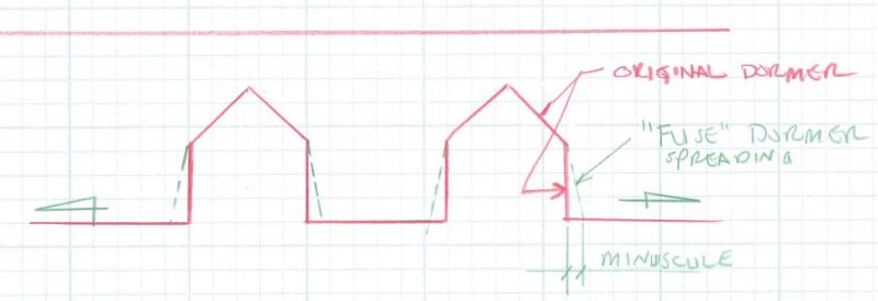

The dormers are "open" so any spread in their sidewalls would be quite minuscule.

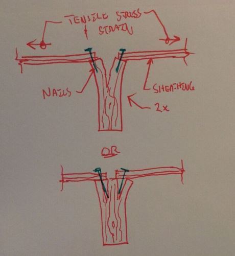

Agreed. My concern, if I really had one, would not be the sidewalls but, rather, the integrity of the diaphragm immediately surrounding the "notch". Particularly the re-entrant corners. Rationally, it's another solid argument for some offset chord elements there for reinforcing.

Quote (Kootk)
But drift is not strain. For example, with the same diaphragm center line deflection, a deeper diaphragm will have more strain. So while half diaphragm drift and eave drift may be the same, half diaphragm chord strain and eave strain will not. The eve strain will be amplified.
The 1" drift is at the outer edge of the building - depth of diaphragm doesn't matter.
You would design your diaphragm to limit the building drift (I haven't even talked about shear wall deflection so your actual diaphragm deflection would be really, even less.
From that you back calculate the diaphragm deflection from the limit of drift at diaphragm midspan. So whatever depth of diaphragm you have - be it 12 feet or 12000 feet, the arc of the outer edge of the diaphragm is still just 1" or so and the strain in the diaphragm is still based on the difference in length of the straight diaphragm eave line and the arc length of the deflected diaphragm. Hoooke's Law forever.
The sketch you show assumes that the strain is all concentrated at some brittle connection where in reality you have all sorts of fuses along the line....think about the additional deflection we add to our shear wall deflections due to nail slippage. Also the dormers are giving up a huge amount of stiffness through the length so any possible build up of strain will be simply lost in the dormers.
A 3" lateral diaphragm deflection on a 100 ft. long diaphragm eave results in a net gain in arc length of 1/64" approximately.
The strain from that is very small (1.3 x 10^-5). Waste of time to even bother with it.
You would still have double top plates, continuous blocking or a collector of sorts along the edges between the dormers to help pull the thing together where it can - but the strain is nothing.

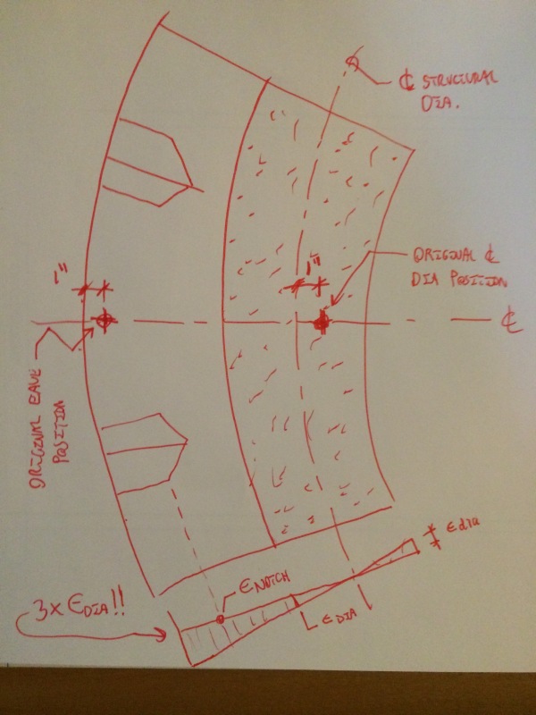

Quote (JAE)
Hmmm...not sure you are getting my drift
Nope, still kicking up dust. Please review the sketch below, in particular the details of the strain diagram at the bottom.
Quote (JAE)
As I see it, per the sketch below, eave strain will be 3X peak structural diaphragm strain precisely because of the width of the outstanding diaphragm.
Quote (JAE)
You would design your diaphragm to limit the building drift...From that you back calculate the diaphragm deflection from the limit of drift at diaphragm midspan.
There's nothing to back calculate. Per the sketch below, the magnitude of the drift at the eave will be identical to the magnitude of the drift at the structural diaphragm center line. It's the strain that will differ.
Quote (JAE)
Again, I believe this to be your fundamental source of error. The arc formed by the 1" displacement is only part of the story. The far ends of the eave also spread further apart which add more axial strain. Vastly more. This is quite analogous to, say, reinforcing a wide flage beam with a WT on the bottom. The WT isn't just displaced downwards, it's stretched. And that composite stretching is the source of our VQ/I stuff.
And what would these fuses be? All I see is some axially stiff sheathing panels and some nailed joints. Do you really think that you'll get meaningful nail plowing action through the plywood prior to the tension perpendicular to grain failures that I illustrated above? I don't.

The eave strain between dormers will be unaffected by the presence of the dormers. Eave strain at any location in the non-structural diaphragm will simply be a linear amplification of the strain in the structural diaphragm as I've shown below. And the structural diaphragm isn't notched.
Quote (JAE)
A 3" lateral diaphragm deflection on a 100 ft. long diaphragm eave results in a net gain in arc length of 1/64" approximately. The strain from that is very small (1.3 x 10^-5). Waste of time to even bother with it.
I'd be happy to play along but we'd have to assign a width to this diaphragm in order to calculate meaningful results, for the reasons mentioned above.
Rationally, I feel that one must acknowledge the presence of meaningful strain at the edges of diaphragms. For that strain is also the strain in our diaphragm chords. So if there's not meaningful strain in our diaphragm chords, how do our chord forces come about? 1/64" in 100 ft is a strain of 0.00015. That's not going to generate any chord force.

Quote (JAE)
Your sketch assumes flexural deflection. Diaphragms have significant shear deflections so that 3x rotation, and your sketch, isn't all that meaningful or correct...Even with your not-correct flexurally deformed diaphragm,
While I agree that wood diaphragms undergo significant shear deformation, the assertion that my flexural analysis is meaningless or incorrect is seriously flawed.
1) Just because shear deformations exist, that's no reason not to bother looking at flexural stresses strains.
2) If flexural stresses and strains are not important or relevant, then why bother with chords? We certainly don't bother with them to deal with shear deformation.
3) Shear deformations are additive to flexural deformations. As such, you'll see the 3X strain shown in my sketch and then some more drift as a result of shear deformation.

Providing a chord (like (2) 2x6 top chords) isn't going to change the strains in other elements of the diaphragm or dormers anyway. The total deformation of a diaphragm isn't affected by the chords all that much as a larger proportion of your diaphragm deformation is shear-based. The chord does nothing to reduce that.
This is getting a bit tedious so I'm signing off this thread. All I'm saying is that you could use a half diaphragm successfully. I've done it before. It works.
Quote (JAE)
Your flexural only sketch was incorrect in that it attributed all of the deformation to flexural behavior. Thus my assertion that your drawing was incorrect, was correct.
I was interested in studying in-plane axial strains in the diaphragm. That was the scope of my analysis. Given a particular diaphragm load, flexure contributes to in-plane axial strain and shear does not. Therefore, my diagram was 100% correct for the purpose for which I created it.
If one starts with a limit on drift and some of that is eaten up by shear does that mean that there will be less drift going into the flexure bucket? Yeah, of course. Does that invalidate my analysis of the fexural strain component? Not at all. Note that nothing about my sketch contradicted the notion that shear contributes to diaphragm deformation. I simply did not choose to study that nuance. If you want a sketch that does speak to shear deformation, I suggest that you create one of your own.
Quote (JAE)
.but my assertion that the arc length results in small strains is correct regardless of the share of deformation between flexural or shear based deflections. I even said that even at 3 x the deflection (your incorrect assertion of a flexural only deformation) the strains were small...that is still true.
You seem to be getting stuck on the magnitude of the strain. I don't care about the magnitude of the strain. In almost every one of my posts here, I've repeated clarified that:
1) I, like you, think that the magnitude of the strain is small.
2) I, like you, suspect that the strain is not a serious concern in practice.
We do not need to continue faux-debating whether or not the strain is small or whether or not it's a serious issue in practice. We've agreed on that from the start.
Yes, and I have not really disputed that. I merely mentioned a slight concern, of my own, for strain beyond the designated structural diaphragm. And I feel that I've done a reasonable job of legitimizing that concern here.

There is one fundamental disagreement that should not be overlooked. We clearly disagree on how chord/diaphragm strain should be calculated. I think that diaphragm depth factors into it in a big way. JAE doesn't think that it comes into play at all (my interpretation of his comments). That's kinda huge.
KootK that is not really representative of what I said. I don't believe that it doesn't come into play in the derivation of the strains at the outer edge.
What I said was that if you design a half-diaphragm the resulting design checks (which you correctly advocate) can determine that the outer arc strains on the eave are under control, or limited.
The true diaphragm drift is a combination of shear deformation (roughly shown here):
AND Flexural deformation - that you illustrated in your sketch above.
I commented that your sketch was not really correct - and it is not - it ONLY shows the flexural deformation of the diaphragm and ignores the significant share of shear deformation.
You provided that flexural deformation sketch to support the notion that the depth of the diaphragm affects the resulting arc length at the eave, which it does - but not 100% as you implied.
I agreed that there was additional strain at the outer eave but again - not due to 100% of the flexural deformation (the 3 times value you showed) but the TRUE eave strain would be somewhere below that amount.
The influences of both are present. For most diaphragm sizes in wood construction, the shear deformation tends to be more influential in the total deformation than flexural but then I even conceded that if the 3 times amount you incorrectly showed was present, you'd still have small amounts of strain in the chord, which you agreed.

Quote (JAE)
I do not accept your assessment that my sketch was incorrect. It was utterly correct with respect to what I was attempting to convey: the nature of flexural strain here. My diagram was, perhaps, incomplete with respect to what you wanted to see acknowledged: the influence of shear deformation on felxural strain in a limited drift scenario. How about that?
Quote (JAE)
My sketch did not say that 100% of the drift manifested itself as flexural deformation. My sketch said that eave flexural strain would be 3x half diaphragm flexural strain. And that is true.
Quote (JAE)
I see that this discussion seems to be devolving into an "I can out-quote you last" so I'll concede the thread and let you have your way with your quote machine
Please don't be put off by the quoting. I know that it feels like a personal attack at times (that's how ego endowed creatures are built) but I really just do it because it's an efficient way for me to thoroughly and systematically process all of the points of contention. I'm an engineer after all. I find that when others don't quote, that's when in depth discussions really devolve into pitiful messes.
We've known each other for a while now. I would hope that you would think better of me than to assume that I'm engaging in some kind of petty "quote arms race". If I bother to say something, it's because I feel that it has substance. If you want to be done here, then be done. You can't expect me to stop discussing things with you when you're still discussing them with me however. I like it after all.
While I suspect that you will not be interested, I still think that there's an important point to be resolved regarding the calculation of chord diaphragm strain. Given my druthers, I would like to:
1) Have you supply your calculation for the 1/64" elongation number.
2) I'll do my best to produce a calculation doing it my way.
That way, we can objectively attempt to resolve something meaningful. How about:
1) 100 ft X 30 ft diaphragm.
2) 3" midspan deflection based on a parabolic flexural curve.
3) You specify the percentage of deflection attributed to shear based on your original calc.
I'll invest the time if you'll share your stuff.
