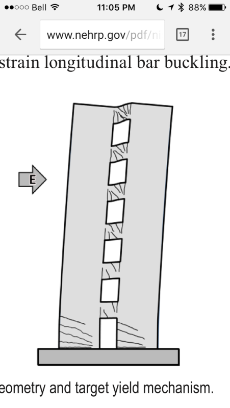

@TME: question for you as this has me curious now. We don't know that this is a lateral/strength thing yet but, for now, let's assume that it is. I imagine the process unfolding something like this:

RE: Help identifying this crack pattern in concrete walls
Quote (Robbiee)
I agree with you regarding the coupled shear walls you noted above, but do you see these panels put together acting as coupled shear walls? I see more of a frame behavior.
Yeah, I do. I puzzled over it a while myself though. Here's what I came to:
1) I expect you'll have the superposition of two types of behavior: cantilevered wall/frame for which coupling demand would be a maximum up high, and shear mode building sway (moment frame) for which coupling demand would be a maximum down low. I have trouble wrapping my head around the full complexity of it but this is why my gut tells me that max demand may well be in the middle, where you've got some of both going on. Were I in your shoes, I might try to quickly model something of similar proportions just to see what kind of behavior really does shake out in this regard. That could probably be just an afternoon's fun so long as you're not getting to hung up on trying to model the real thing accurately.
2) Without doubt, each bay of stacked panels will exhibit some coupled shear wall behavior. In my mind, the real question is whether or not the whole wall will act as one frame or the individual bays will act like several, separate shear wall systems. To explain where you do and don't see cracking horizontally, the entire wall would need to be acting as one. That makes the middle the location of peak vertical shear. I'm guessing that the connections are such that the entire wall would act as a single system but I'd need a look at the connections to be sure-ish.
I think kootk is on the money with his diagram screenshot he posted. this is why there is no cracking on the bottom levels. this is a coupled wall situation
whether or not its a safety issue at this point is not our judgement call to make, but as an armchair engineer back home with no skin in the game, I would say its not a big concern. I might request a concrete scanner to swing by for $500 just to make sure there is a bit of steel around that opening.
Robbiee,
It looks like the designer of the steel layout within these walls didn't consider coupling wall behavior. that's why there are so many verticals, but few horizontals.
