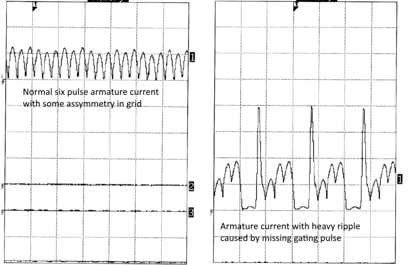

Harmonics on the AC side will start with the 5th harmonic. That is very close to the natural 6th harmonic that is a natural result of the six-pulse rectification and will be a very miniscule in relation to the latter.
A couple of examples are given below. AC harmonics does not add much heat to what you already have.
