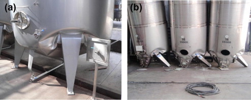

Somehow, grapes are frequently grown in arid earthquake prone areas.
Consider spending a few extra bucks for a either a full-skirt tank support or brace the tanks at the top of the shell.
An earthquake analysis by a competent structural engineering consultant can be money well spent ... considering the value of the liquids stored ....

RE: Wine Storage Tank
The tank failures shown above are because of the "cheapie" triangular legs commonly supplied by "low-bid" suppliers.
You should keep in mind that wine storage tanks are commonly configured as "tall skinny tanks" ....
This particular shape is particularly susceptible to extreme and expensive earthquake damage.
Some thought should be given to tank anchorage and tank room layout ........
Regards and please tell us more ...
MJCronin
Sr. Process Engineer
