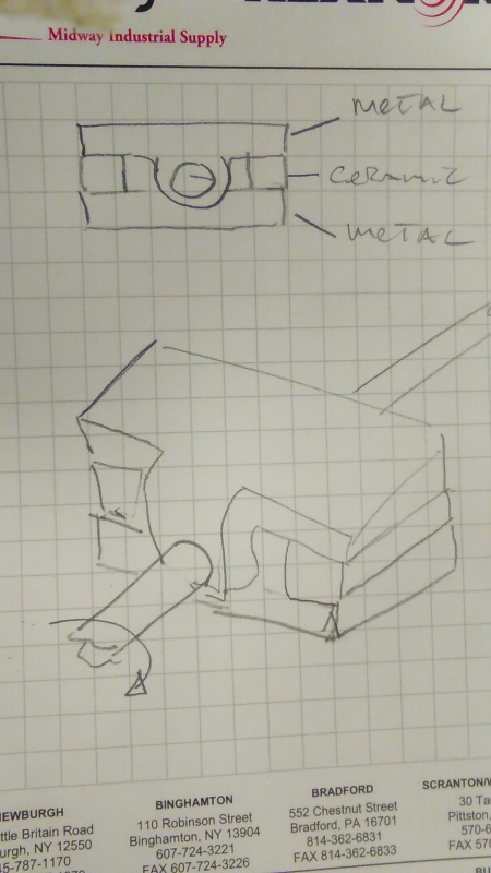

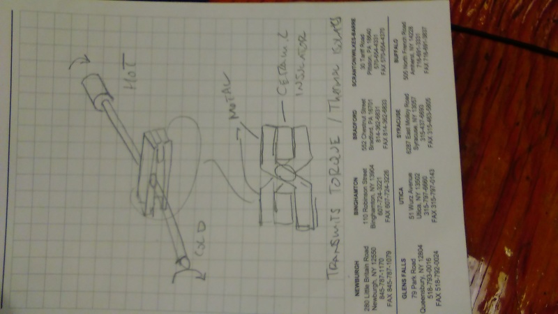

RE: Fasterner's tighening torque measurement in real time at high temperature
See sketch of device to transmit torque while isolating thermally.
Rev A.
