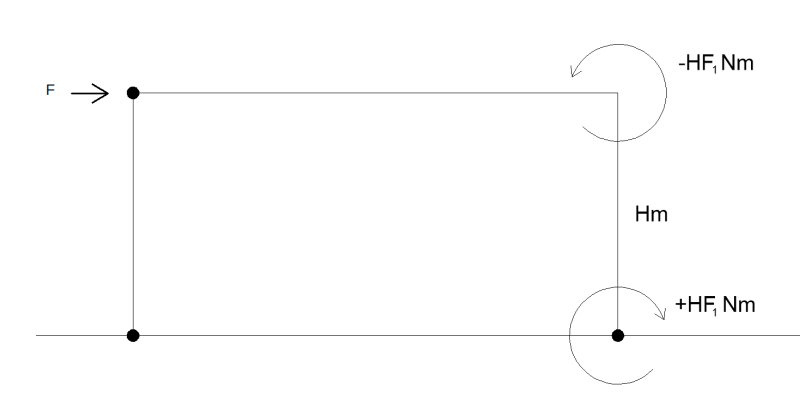

RE: Joint design of a post and beam associated with a knee brace.
Bearing in mind I'm still self teaching (as distinct from taught) structural engineer....
Timber framing manuals produced by the Timber Framing Guild recommend to ignore the effect of braces under tension.
So I don't think you can assume the point of inflection is centered in the beam. Rather I would say the point of inflection is at the knee brace.
So I'll outline my thoughts and see if my reasoning is ok.
Simplifying the diagram....

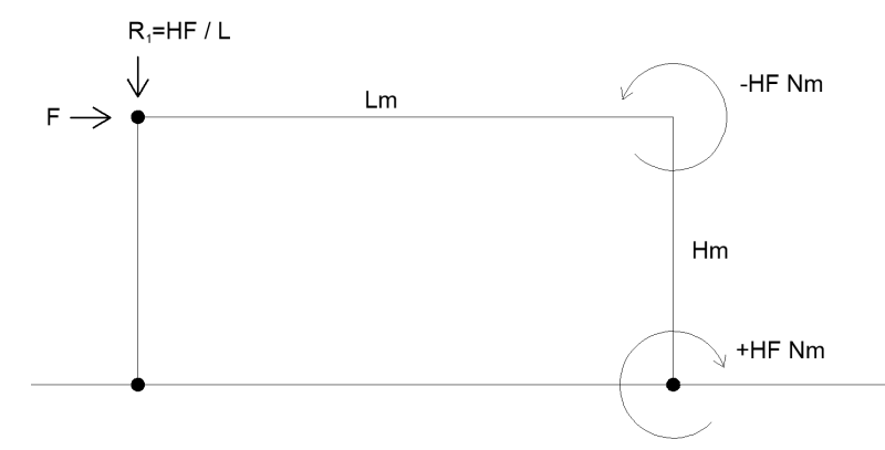

The load wants to cause the posts to tip over. So there must be a moment about the hinge at the bottom of the posts. Considering the right post this moment would equal the load (F) by the length of post (H). Since the frame is in equilibrium there must be an opposite moment at the top of the post. The only place within the frame that is resisting the load in a way to prevent the frame collapsing is the joint at the top of the right post.
The moment at the top of the right post must be being formed by a force drawn from the beam. If this joint is rigid and the joint at the top of the LEFT post broke then we would expect the rigid frame of the right post and beam to rotate as a unit.
Since this isn't happening there must be a downward force within that hinge joint formed by the top of the left post and left end of the beam.
Having found this reaction force I added the brace back into the diagram. Here we see that the placement of the brace can massively effect the force on the right post/beam connection. The smaller the brace the greater the leverage on the joint.
Calculated the forces on the beam by treating it as balanced about the top of the brace. Which gives the vertical reaction (R2) at the top of the post.
To get the horizontal reaction and presuming the brace is at 45 degrees the lateral load on the post (R4) is equal to R3. That allows me to calculate the lateral load at the top of the post (R6).
So how did I do?
isn't the structure the the right of the pinned column a two force member ?
doesn't that mean that the frame is putting the column in tension.
You can draw a FBD of the overall structure to see where the off-set couple comes out.
Quote (OP)
Didn't know that. Can you point me to a document that I can review?
Quote (OP)
It wouldn't be at the mid-point or anywhere else in the beam. You'd no longer have any inflection points anywhere in the system with the bases pinned.
Quote (OP)
So how did I do?
I wouldn't consider the column base to be moment fixed. The system is stable without that anyhow.
I've got a bunch of the publications from the TFG but the most relevant two are:
http://www.tfguild.org/store/timber-frame-joinery-...
"It wouldn't be at the mid-point or anywhere else in the beam. You'd no longer have any inflection points anywhere in the system with the bases pinned."
Probably shouldn't have used the word "inflection". There would be deflection about the brace.
Is the approach I've used wrong? Good enough?
I'd've thought the overall FBD would look like ...
