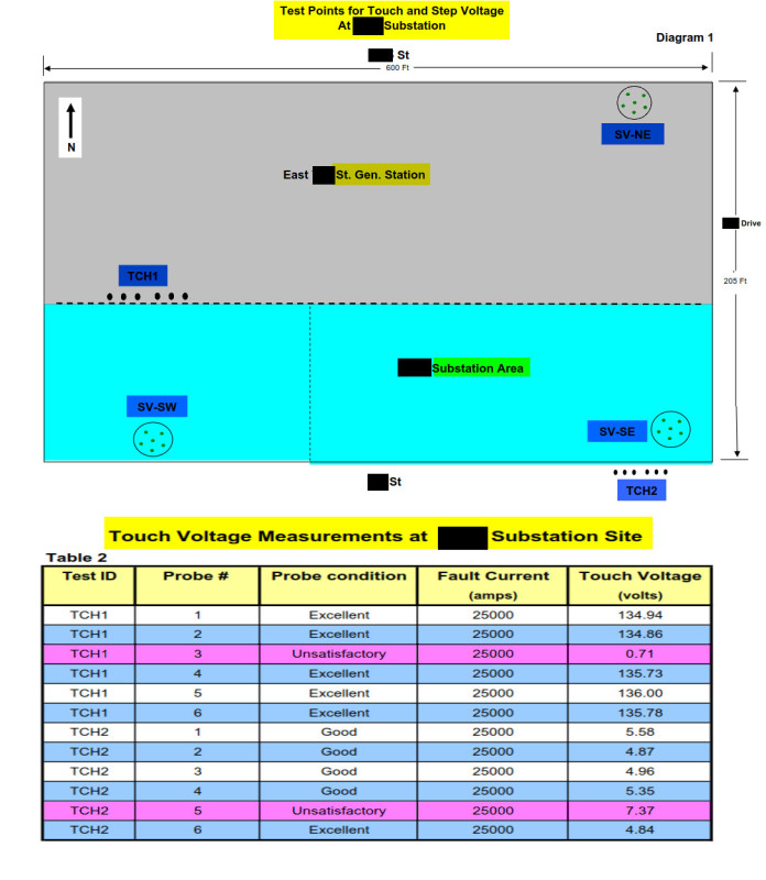

i have a follow up question for cuky2000 and magoo (and anyone else really):
i have a testing subcontractor that can measure GPR + step/touch potentials, however is claiming that the best place to do this is outside the plant building in the back field.
i don't understand that. if there are any GPR/step/touch potential hazards to be concerned about, wouldn't they be inside the building where the equipment is and the operators may be walking around? what would measuring GPR/step/touch outside the plant building accomplish?
the grounding studies i've seen in the past are done using modelling the grid, soil resistivity, etc and running simulations that produce nice graphical views of the GPR/step/touch potentials INSIDE the plant....
RE: Ground Potential Rise in an existing Generation Facility
Grounding measurement requires inserted probes into the earth in the target measured area. For indoor testing on the power plant, holes need to be made in the concrete slab and some contractor may be reluctant to hit something below grade that gets into liability issues.
I was involved a few years ago in an unusual grounding analysis for a new indoor substation to support a superconducting project to be built in for an old coal power plant building built in 1920. The building was housing a modern combustion turbine in operation with the original grounding conductor running above the basement floor but connected to each steel columns and foundations. The plant manager does not allow cutting the slab and installing a new ground grid.
To determine if there was any issue with the step and touch potentials, testing was performed using a Hood-Patterson & Dewar Smart Ground Meter, Model SGM-2001 with Win SGMD 5.1b software. We convinced that plant manager to allow drilling in the concrete slab of the basement 1 inch diameter set of holes to insert test probes 3/8 inch in diameter to a depth of 18 inches. These holes were then filled with a soil mixture in order to guarantee a good connection between the probe and the surrounding earth/concrete. Underground utilities as well as rebar were present during the time step and touch voltage measurements were taken and analyzed in case impact the results obtained.
To the amount of underground metallic conductors including steel rebar in the concrete slab the end result was satisfactorily without the need to cut the concrete and insert a new ground grid. To maintain the safety integrity on the basement in the event of large fault from the new substation and the superconductors the new substation grid and the old plant grounding system were interconnected to few deep ground electrodes built across the street and interconnected with the steel encased of pipe-type cable and the sheath of new HV solid dielectric cables.
I hope this help.
http://www.ap-concepts.com/win_sgm_func.htm
Below is an except of the Step and touch potential measurement inside a building.
