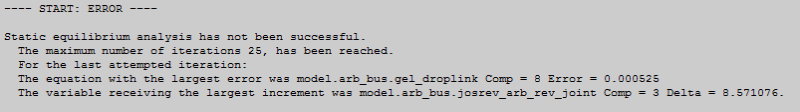

Hello,
I am building a suspension geometry for the FSAE competition and I have a problem. The anti-roll bar does not work in the simulation. I have built the communicatoes and the joints but it does not work. Can anybody help? Thank you in advance!

Did you overtake the issue ?
Long time ago I received same error, but take a look at the model from "acar". If I remember well, then it was something about deactivated mount parts.
Also check the matching name between CIL(R) and COL(R).

Hello,
yes!It took me some time of checking and changing communicators and everything and then I found out that the problem was a missing fixed joint.
Thanks for the advice though!
