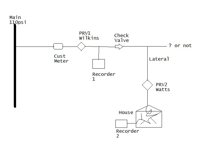

I work for a utility and we have been having a long term issue associated with a customer's pressure. The customer has had some leaks, one of which resulted in the loss of a significant amount of water. There are a number of issues, including the customer's internal piping which is a mixture of materials including Qest. We've notified the customer of this and have been working with him - initially trying to provide the information to him to allow him to install and maintain his own PRV properly. Other issues have come up and we've gotten more involved as we are being accused of being the source of the issues. The customer is served by a small diameter line (likely a 1" galvanized line) that we intend to replace as part of our ongoing line replacement program. In the meantime, I have been unable to make sense out of what is happening at this customer location. There 3 other customers on this line, this customer is at the end of the line and is the only one having issues (that we know of).
The description of the set up at this location is as follows:
System (105-110 ave. press.)-->Customer Meter-->PRV1 (Wilkins)-->Tee for Press. Recorder 1-->Check valve (inline ball check)-->Lateral to house-->PRV2 (Watts)-->House plumbing-->Press. Recorder 2
The customer watches his internal gauges constantly and calls whenever the pressure is above 70 psi. We have several charts showing something that I am not able to explain. I have attached one. The pressure routinely climbs above the setpoint of the PRVs. Initially it appears that is could be thermal expansion and we added a check valve to the line in the anticipation that this would provide the data needed to demonstrate this or that something internal to the home is adding energy to the system. However, the data following the installation of the check valve (between the 2 PRVs) shows that they both increased in pressure and continued to track along with each other. The check valve is new and I guess there is a chance that it may not be working properly but it didn't seem probable. We have adjusted the PRVs and they continue to allow pressure to go above the setpoint. As a result, we continued to receive calls. The PRVs are direct acting 3/4" valves - both are relatively new.
To try to keep the pressure from being seen on customer side we also installed a pressure relief valve after the first PRV that would keep the pressure at 65 psi. This worked for a few weeks but we are now seeing that the PRV upstream from the blow off will no longer maintain a pressure setpoint - we make adjustments (while flowing a small volume of water) but as soon as we stop the flow, the pressure climbs over the setpoint and up to the relief valve setpoint (10 psi higher than the PRV setpoint), which will then run/drip almost continuously.
Any thoughts/suggestions on this would be appreciated.

Just to be clear is this exactly what the setup is?
Seems odd the house pressure is higher than the post meter pressure.
PRVs require working pressure to drive their functioning. If the after-meter PRV is set at or below the house PRV the functioning of the house PRV is undefined.
The check valve does seem to make having the house raise the pressure back to the meter less likely. Did you have the same result without the check valve?

RE: Pressure/PRV Issue
@itsmoked:
The drawing you have is close - there is no tee and additional line running to the question mark. The Watts PRV is located inside the house but schematically, what you show is good.
It is difficult to know what is going on with the in-house PRV. I have no confidence that this one isn't being adjusted by the customer - he has a post-it note on the wall showing direction of rotation for raising and lowering the pressure. The one at the meter is the only one that I have some general confidence that it isn't being tampered with.
I'll look later today for data that is pre-check valve.

Utilengr
I see 2 possible causes
You mention there is a bladder tank on top of the water heater,
Quote (He has a small expansion tank mounted above it.)
has this device been checked to see if is not flooded. The bladders do fail and eventually the tank fills up with water providing no protection. The water inside the heater expands upon heating which in homes without PRV or check valves a small amount of water is vented back to the system.
Is it possible there are bits of rust from the service line breaking loose and lodging inside the PRV's causing the PRV's to bleed through? have the PRV's been disassembled and inspected to verify they are working properly?
My bet is on the first one.

It's simply the expansion tank pure and simple not the PRVs.
Reasoning: Notice the time it takes to pressurize? What's the typical time it takes a water heater to re-heat? 10 to 20 minutes. The rises take 12 minutes.
Notice the periodicity of the these rises?
About as frequently as a water heater cycles in a typically un-busy home.
Notice the pressure rise is always with the same rate-of-rise.
Sometimes it doesn't reach clear up to peak pressure seen because during the water heat up water is used in the home; a toilet flushed, hands washed, washing machine uses again, etc.
Why would a PRV only occasionally leak? Virtually every problematic water device I've seen from PRVs, valves, check-valves, water heaters, facets, etc, etc, down to a hose spray nozzle, if they have a problem they almost always keep the problem or the problem grows with time.
If somehow the PRV was faulty and leaking why would it leak at the same exact rate? If debris were sticking in it they'd be different sizes causing different leak rates.
It's the blocked system having a tank filling a volume considerably larger than the rest of the plumbing then heating that volume 60 or 70F°.

Thanks for all of the replies/suggestions. This has been helpful as we continue to work through this. I have some updates and believe we may be honing in on the issue.
We spent about 2 hours at the house a week ago in an attempt to slow the constant drip from the relief valve. What we discovered is that adjusting the relief valve set-point up didn't slow the flow - even as we approached system pressure. This indicated to me that the PRV was no longer working. Coincidently, the owner left while were there so we were also able to remove the meter and check for any pressure building from the customer side - this was eliminated as a variable.
The customer has a whole house filter on the incoming line (after his PRV located in the house). We schedule a time to remove the filter cartridge. The owner had replaced the cartridge about a week prior. What we obtained in the sample is shown in the attached. These particles would have travelled through both PRVs prior to ending up in the cartridge housing (at the bottom). They settle quickly, some are magnetic. If this is getting to this the filter, I would suspect that some larger particles are staying in the PRVs.
While there to look at the water filter, the owner's plumber just happened to be there. I suggested that he have his plumber check his expansion tank to make sure it still has air in it (he has a standard tank hot water heater). He called me the next day and said that he decided to just have his plumber replace it. Not what I was looking for but this variable should also be removed. (The check valve in the line should have also prevented the pressure from getting back to the first logger near our meter, so I've had a hard time with pointing to this as the problem.)
We're ordering a repair kit for the Wilkins PRV to give us a chance to confirm our suspicions. I understand that the Model 70 Wilkins has a 40 mesh screen in it but I don't think that's going to be good enough based on what we're seeing (evidence was in the filter). I must say that I was surprised the customer never pointed out or complained about what he was seeing in the filter. This would have tipped us off a little sooner.
@coloeng, We are working on a replacement plan for the service line as well. I believe that the configuration of his connection is also detrimental given what we are now seeing - I think his connection, which is at the end and downhill from the larger main, is right off the end of the line. This isn't how we typically make a service connection. Typically, we put the corp. stop above the spring line angled up at about 20 degrees. This would help keep some sediment/debris from moving through the service connection. We need to fix this.
