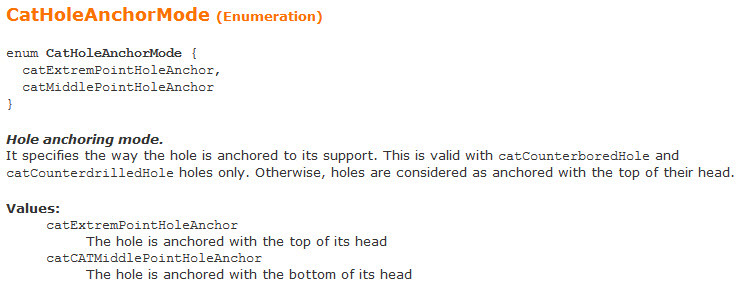

I'm trying to create a rule, to change the anchor point, controlled by a parameter, with knowledge advisor.
Anyone knows how to do it?

That works in a macro, but I want to make a rule in Knowledge.

Pull up the Formula Editor, then select an existing hole that has been configured with the preferred settings. There is a high probability there is a Parameter that will control that behavior that you could utilize with KW functionality.

that property is no available. I solved already the problem, with a reaction linked to a "VBScript with argument" feature .
