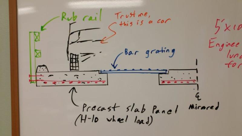

What about precast deck panels with bondout areas for bar grating. This would give you the best of all worlds; a relatively inexpensive and easy deck design, a nice bridge surface, a "see-through" area with cheaper and easier to replace grating for the "cool" factor.

TehMightyEngineer, so you would basically need a drain hole in each panel....is that right?
I guess I would see that as sort of a leaf / debris trap.....interesting concept though.

Quote (bigmig)
Depends on what your ultimate goal is. Could make it act as a drain but I was thinking more like a divider between slab panels. Sketch:
