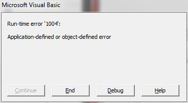

I'm having trouble with the following code throwing an error:
Worksheets(1).Range(Cells(22, n + 2), Cells(23, n + 2)).Value = Worksheets(2).Range(Cells(4, n + 2), Cells(5, n + 2)).Value
Where n is the loop variable in a For loop.
It think the problem lies with referencing Worksheets(2), but why?

What is the text of the error message?

RE: VBA code won't run
Please refer to the code I posted.
The Cell Object defaults to the ActiveSheet. You must explicitly reference the Sheet to the Cell Object as per the posted code.
The error you got reflects an ambiguity in your code.

Skip, that makes sense I think. So without using With as you did it should look like this?
Worksheets(1).Range(Cells(22, n + 2), Cells(23, n + 2)).Value = Worksheets(2).Range(Worksheets(2).Cells(4, n + 2), Worksheets(2).Cells(5, n + 2)).Value
You need to reference WorkSheet(1) with both Cells objects within the Range() object
