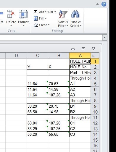

RE: nx8.5 Drafting create hole table problem
Note that the table is not empty because
If I select the table by draging a window around the table(the single line) and right click
and select edit by spreadsheet I get the hole table as shown in this picture

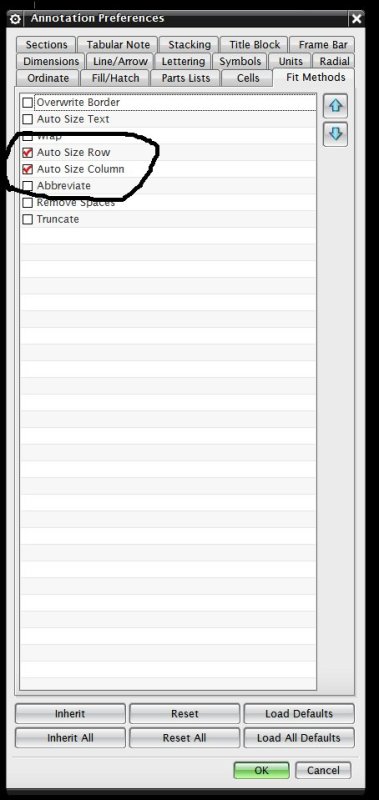

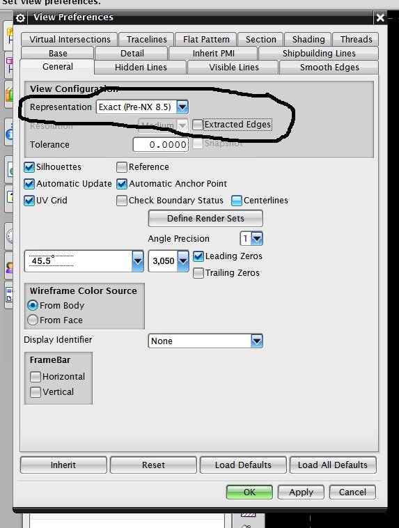

As I suspected some setting must be applied
for the hole table to operate correctly as in these pictures
These setting also make the "window selection" to opperate correctly
I'll use these settings only when I need a hole table.
in other cases I'll use the exact view style.
