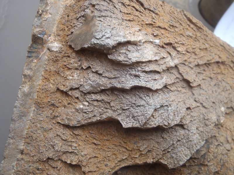

This casting failed over the holiday break.
Here are the shots of fracture surface:
All these ridges and facets, does this look like "rock candy" fracture? I'm thinking of asking for Al and Boron content tests.
Why is there this different layer on the outside?? Brittle fracture inside then ductile failure on this shinier layer??
Other side survived.
The casting will be in town from the site next week, trying to get my head around & see if there's any obvious hint what happened here.
Thanks for looking & your comments highly appreciated.

I can not help to notice strange oxide over the failed areas. I would expect it to be a clean bright surface. I admit I am not a casting specialist but these are common sense approach ideas.
RE: Another casting failure
.appears to be ductile overload failure. There appears to be cold deformation
The fracture morphology looks more to me like fracture began at the weld repair. The origin you identified could be a second origin but more likely it was an extension of the crack that started at the weld. Without knowing the base material of the casting, I want to ask if 309 is an acceptable material for such a repair. Does it have compatible thermal expansion/contraction properties with the casting material? Why did a repair have to be performed there in the first place? If a crack was present as the reason for the repair, are you sure it was completely removed at the time of repair?

Material is cast steel (Avg 0.2% C, 1% Mn, 1.8% Ni, 1% Cr, 0.4% Mo) with yield strength of minimum 700 MPa.
Repair weld was done by the foundry without our knowledge, we found out only after it failed.
Foundry is supposed to tell us before doing any kind of repair. We are using this foundry for the first time & they seem to have some serious issues.
We usually do not use stainless wire for our weld repairs.
On a side note we have asked a third party to do detailed failure analysis, they will be starting work from next week. I'll update with their finding as soon as I get them.
Any hint what these big steps in fracture face indicate?
Thanks.
The steps are called ridges and are formed from multiple fracture planes.

It is difficult to tell for sure, but is it possible there were two welded repairs, the tack weld to the right in the photo and a weld to the left? The left edge of the lug looks similar to the tack weld on the right side.
The weld interface between the type 309 weld deposit and the casting would constitute what is called the mushy zone where there is partial melting and alloying between the filler metal and the original base metal. The chrome and nickel from the 309 filler metal would increase the hardness of the mushy zone due to the increase in the carbon equivalency. Even without an increase in Ce, the HAZ would form a metallurgical notch. Such a notch without an increase in hardness could still be a cause of crack initiation.
It would seem that it would be better if they had made the repair with a low hydrogen high strength low alloy electrode (8018-B2L) or a low hydrogen welding process using a high strength low alloy steel filler metal. That would mitigate the increase in Ce in the mushy zone and the associated higher hardness assuming the contractor used appropriate preheat before welding. Small repairs, without the benefit of preheat on a thick casting, could still experience high hardness if the weld cooled quickly. Did they repair the casting using 309 filler metal with the mistaken belief that preheat would not be required?

An update, just got hands on some preliminary mechanical tests results:
Material is too brittle, for Charpy our specs ask for 40J at -40 degrees C. Also Tensile strength is some 200 MPa below our minimum requirements.
Chemical analysis meets specs, so may be they didn't tamper it to high enough temperature?

Looking at this from a foundry perspective. With a 700MPA yield I am assuming this is a 120ksi/100ksi (tensile/yeild). How thick is the part? It looks pretty beefy from the pictures. What specification did you order it to? The chemistry looks like a 4320, which is a good match for the section and mechanical requirements. Where did you take the mechanical samples from? Was there any evidence of porosity in the tensile and charpy specimens?
The reason I ask, material properties out of castings are not directly comparable to the test bar results. Test bars are over rigged to ensure no imperfections in the metal. If you ordered to a specification that allowed for standard 1 1/4 x 1 1/4 sized test bars to represent such a large casting that may not be appropriate. You will see a large difference between the part and test bar properties. If you ordered to a spec that required and equivalent round test coupon like API or ASTM A1001 the properties will be better represented but still can differ from the actual part depending on where you took your test coupon. The API and ASTM A1001 require the test coupon to be taken at (1/4)T (API) or (1/8)T and (3/8)T for A1001. You should not be taking the samples out of the direct center of the section thickness.
Any porosity in the sample coupons will give you low ductility and low impact values. That porosity may be completely acceptable per the specification. That is why we should be careful when comparing mechanical results out of parts.
Now 31 ft-lbs at -40° out of a 120ksi material is pretty stout for a 4320 material if you expect that out of a test coupon 4" or above. If, the mechanical coupons show no evidence of porosity at the fracture surface and the test coupon were taken near the 1/4T section, from the tensile results it looks like the quench was not adequate to completely through harden.
On the weld repair. 309 is not the proper electrode to weld repair this material. Any weld repair done should have underwent PWHT no matter what filler metal was used.
