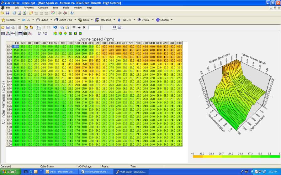

Typical MBT ignition timing on an automotive gasoline engine running under load (when it matters) is 20 - 35 degrees BTDC depending on how good or bad the combustion chamber is. (A good fast-burn chamber will need less ignition timing to achieve best torque.)
Here is a randomly selected ignition timing map. RPM is increasing across the top, engine load increases as you go down because the chart is done in terms of trapped air mass per stroke.
http://www.castlehillexhaust.com.au/files/hsvspark...
24 degrees BTDC, or pretty close, ignition timing at full load at 2800 rpm and up.
