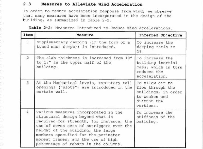

I don't care what the engineer says when a building gets that tall and that extreme of an aspect ratio, I just call it scary skinny. Even with tuned mass dampers I wonder what its sway is like in a high wind event.

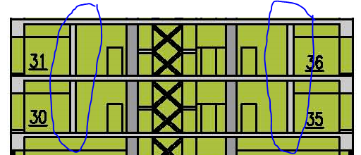

Some random results of trolling. If it's the two storey concrete walls shown, and they're outboard of the core, it would seem to be virtual outriggers.

I have the superstrucure drawings for that one but not the foundation unfortunately. Just took a look and info above looks correct. The core is up to 2'-10" thick, 14ksi, and perimeter columns are huge (36" x 44" for example). Slabs look like 10" or 12" and cambered. There are large embedded steel shapes at various locations. Couldn't make sense of all of them with a quick look but I did see that at the outrigger levels there are embedded wf columns in the verticals and steel beams in the outriggers. The outriggers don't appear to ever be solid, as far as I can tell there is always at least one door punched through. Some outriggers have a weird detail with steel wf beams in the horizontal and then vertically connected between floors with rebar to welded couplers on the wf beams. Other outriggers have a wf diagonal brace. I don't want to post the drawings for fear of some wsp groupie yelling at me. Doesn't look like any magic though, just huge members from high strength concrete, outriggers, and a tmd.
Drifts must be quite high but the tmd would take out the acceleration so in theory you don't freak out.
