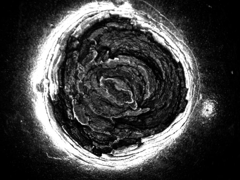

Dear all,
Any idea what is the possible cause of the failure of this angular contact ball bearing? Attached is the photograph of the ball bearing 14 out of 15 balls have the similar pattern on the ball with the initiation site at the center and propagate radially like fatigue striation. The outer and inner raceway show microcrack and spalling but not as severe as the ball. They are 1 inch ball bearings.

Thank you ...noted. Will look for the book. Most of the failure analysis work on bearing dealing with path pattern either on the outer/inner raceway..not much on the ball. In my case the ball spalled badly but the raceway exhibited microcrack probably due to subsurface/surface initiated fatigue.....
RE: Ball Bearing Failure
The image showing the initiation site on the other ball, The spalling then propagated radially. This image shows one initiation site. Other balls had 2 or 3 initiation side and propagated radially.

Since the damage on the ball surface is located in one area I think it is a "flaking" failure. Take a look here for possible causes of ball bearing flaking failures.

it looks like flaking that started at a random area of the ball that then further propagated. when that continues the balls may stop to roll and just slide on the already damaged surface, adding to the propagation. the discoloration of the ball may be the result of heat generated leading to local oxidation of lubricant.
it is hard to decide what came first: flaking and subsequent oxidation or oxidation, loss of heat transfer and subsequent flaking....

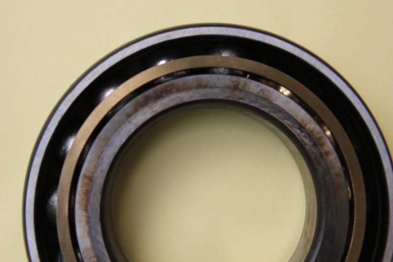

Our bearing type is is 7220 MN MBR SU ,,,Single row angular contact light, 100mm bore, Angular contact low shoulder (both) 40 degree, Machined Bronze retainer , Flush ground, control clearance for duplex mount single package.
Pictures of the races and bearing separator/cage would be helpful.
Please find attached picture of raceways and cage.
Usually angular contact bearings exist in pairs, or even 3s and 4s.
This is with code 72..single row angular contact light that only can handle thrust at one direction..and not duplex.

It is not dark but due to the reflection. No sign of overheating and corrosion. However it has dark circumference..seemed like propagating from the centre as I mention earlier. When we did EDS analysis on this region we found silica, copper and aluminium, oxygen and carbon....Just I am figuring out from where these has come from...especially copper and aluminum...
What is the machine history?
The bearing is used for one year after replacing new RGB (reduction gear box). The indication after replacing this RGB was high vibration ...The bearing is at the output shaft used at the RGB...used in alternator.

Cage/retainer wear is often a sign of inadequate lubrication.
BARDEN and SKF both list machined brass/bronze cage materials having max levels of Fe as 0.3% and Aluminum just .05% max.
Cage wear could conceivably liberate some iron or aluminum I guess.
