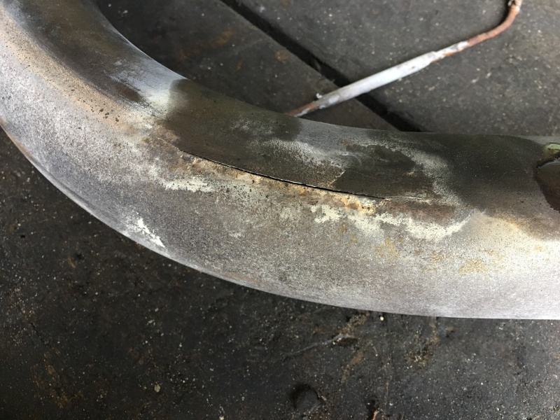

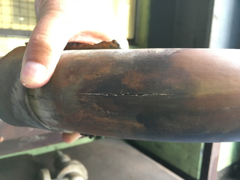

Hi Guys,
I work at a coal fired power plant as a maintenance engineer and lately we have been facing the issue of boiler reheater tubes cracking at bends. I have attached couple of pictures of last two events. One tube had the crack on the side of bent surface, while other on the outside of bent surface.
This appears to be lip fracture (fish mouth?). I have suggested to perform hardness and metallography of the affected tubes. Will that be helpful?
Any help will be appreciated in helping us solve the problem as this is causing forced outages at our plant.

What is the tube material and operating temperature? We may be able to assist in general observations based on collective experience (40+ years). A metallurgical lab analysis of at least one bend failure is necessary to establish a root cause of the failure. I would not have any other testing until this lab analysis is completed.

Hi Thanks for the quick response.
The material for these tubes are SA 213 TP347h and the operating temperature is around 540C

This could be strain induced precipitation hardening (SIPH) which results in brittle material in bends of 347H tube material which have not been solution annealed after forming. I have seen this before for tube bends which were supplied as-formed, and failed within several months - it is not good news. The failures tend to be brittle, thick-lipped failures on the extrados or along the neutral axis of the bend and occur early on in life. Remove one or more of these bends and have hardness testing performed at a reputable metallurgical lab.
Get these to a metallurgical lab for complete analysis. If this is not SIPH it could be cracking related to condensate trapped in bends during off-line conditions. Look at the ID if you can and evaluate the surface.

Thanks metengr for your assistance. After some more research I have come across similar failures associated with SIPH.
After we perform the metallurgical analysis, I will get back with the results and the suggestions provided by lab for any input from eng-tips.

Don't rule out more mundane causes. I have seen rows of pits on the inside of 321/347H where a scratch from cold draw catches water during a shut down.
It could be useful to look at the degree of sensitization/stabilization at various locations in the tube, variations in thermo-mechanical history could be part of this.
RE: Longitudinal cracks on boiler reheater tubes
Another mundane possible cause could be from overheating, particularly short term overheating where cause is actually an upstream leak or obstruction. Even stress corrosion cracking is possible (if, for example, there might be chlorides present within the steam). You really will need that examination by a metals lab as suggested above to know what is going on.
