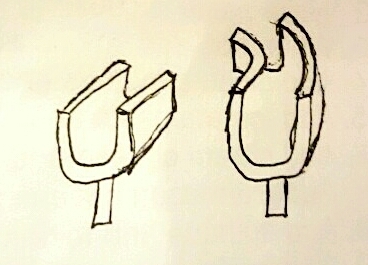

Hi everybody,
For a personal project, I am trying to make a wire cable holder that can hold the cable and then you can bend the holder with your fingers into the configuration you want. I included an image below and I'm trying to get the holder to bend laterally into whatever angle you want and to stay in that place. Was wondering if anybody can offer me ideas on materials or structures I can use to help me achieve that goal? I'd greatly appreciate it - thanks!

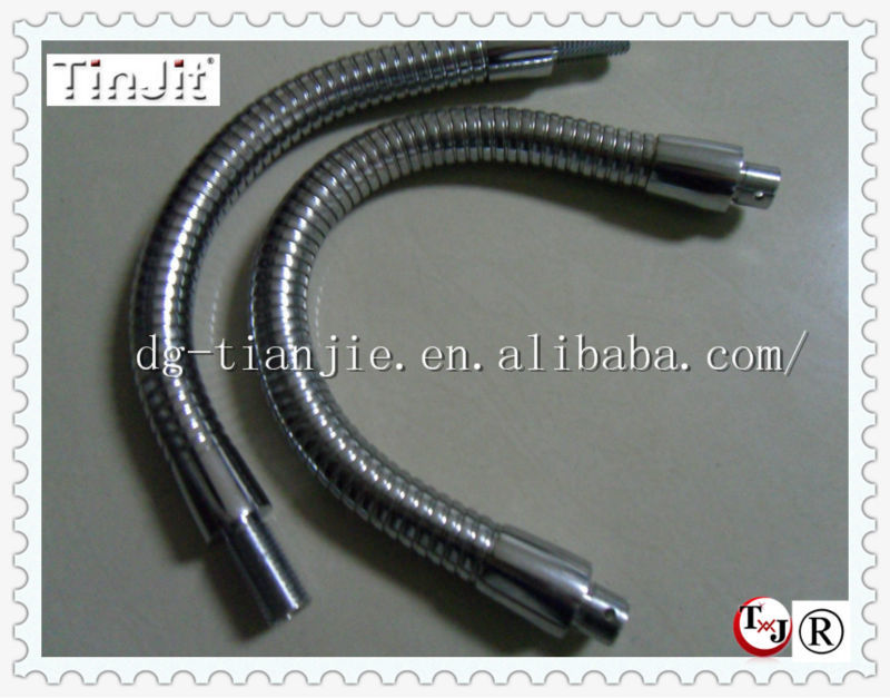

Haha, thanks for your input. I was hoping I could make it hold it's configuration and be able to reconfigure it into a larger/smaller angle if needed. Kind of like what gooseneck tubing does.

I'm a little fuzzy on what sort of configuration you intend to produce with your fingers from the simple preform you have shown. Can you take a shot at illustrating a few typical configurations?

Thanks for your input, Mike. I was hoping I could make a little device that looks as below: which you can bend the end of it laterally to 30 or 60 degree angles and stay in that configuration, and then be able to change it to a different angle if you want it to. I'm not sure if you can make a solid material that can behave that in that way, so was wondering if you knew of anything.

If by 'wire cable' you mean a plastic jacket with multiple small stranded insulated copper wires inside, you might be able to make a two-piece plastic thing with a friction hinge or maybe a ratcheting hinge.
If by 'wire cable' you mean a Bowden cable, i.e. a piece of solid music wire sliding inside a coiled steel wire shell with or without a liner, you will need something fairly sturdy in order to resist the cable's tendency to straighten itself.
Lead might be the perfect material for what you want to do, but its presence may scare civilians and/or 'safety people', who come out of the woodwork regularly.
If you can do without the radial 'lay in' feature you have depicted, and can do axial assembly, consider also annealed copper tubing, which in small sizes can be worked with strong fingers, and will withstand a few corrections.
Friction hinges that actually work tend to be fairly bulky.
For reference, I have a couple of mirror extenders that strap onto my rearview mirrors so I can see around a wide trailer. Between the straps and the mirror housings are a couple of articulated struts with friction hinges. The struts are semi-streamlined, with a cross section estimated at 1/2 inch x 1 inch, obround. The friction hinges are maybe 1 inch diameter and 1/2 inch thick (two halves x 1/4 inch thick each), secured by a single central screw. There may be friction hinges of smaller proportions that work, but none come to mind at this instant. I am getting the impression that something that large might not be what you want.
The gooseneck tubing in the photo retains its bent position because it is coiled with some preload between adjacent turns, probably by twisting the preform strip as it is coiled. This preload provides some friction that resists bending, until the metal either yields or wears a bit. They tend to loosen and lose utility after relatively few cycles.

You didn't answer my question about 'lay-in' as a requirement.
If you can tolerate axial assembly, annealed copper tubing seems a likely candidate.
