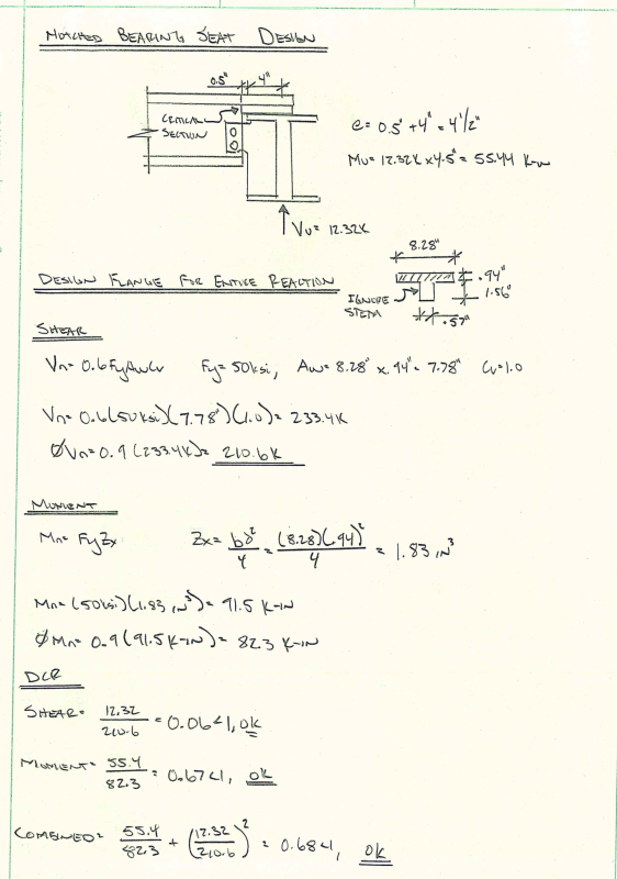

Would it work if you assumed all of the moment and shear went into the beefy flange of the supported beam? Ignore the stem contribution altogether?
Another fix option might be to weld a seat angle on to the girder web stiffener. Take a good look at weld access though.
RE: Field Retrofit of Steel Beam Connection
Hi KootK. I checked it with the stem and it didn't work so I wouldn't think the flange only would work. I'm conservatively assuming the moment arm to be distance from center of girder to notch in beam. If I shortened this moment arm length (induce small torsion into girder) it would probably work.

With regard to using the flange alone versus the tee section, I thought there might be something to be gained if it was the difference between a Zx analysis with the former and an Sb analysis with the latter. But, if you say it ain't so, I'll take you at your word.
The beam seat would deliver shear eccentrically to the girder so yes, in that respect you would have torsion in the girder. I see that as a non-issue however as what you currently have out there already constitutes a moment/torsion connection between members in my opinion. So it's just compatibility torsion.

Thanks, as always for all the input. You all are making me rethink the condition a bit. Sounds like in general most of you are more comfortable with the connection then I was at first glance.
Kootk -- I took a closer look at the notched bearing seat using only the top flange. It looks like it may calc out. See below. Do you agree in general with the approach? I combined the stresses per H3-6 of AISC 360-10. This isn't technically required as I don't have torsion, but as the flange is in both max shear and moment at the same time it seemed appropriate. In reality the shear demand is quite low that it doesn't really matter.

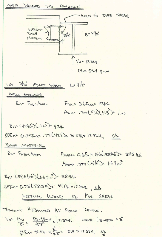

Below is a quick and dirty calc for the welded shear tab. This assumes that the vertical weld on the inside of the plate takes all of the shear and the horizontal welds are only there for moment resistance. As the beam is much stiffer than the plate it seems that this load distribution might make sense. Not completely convinced, but considering it.
With this load distribution, it looks like things work out. The eccentricity is coincidentally 4 1/2" in both directions.
I'm starting to lean towards my Option #1 solution which would involved welding the tab as calced above. Considering it technically calcs out with the notched seat it seems like this added reinforcement may not be needed but would make me feel a bit better about the connection.
Any other thoughts?

Your flange check works for me. I might have multiplied the shear stress by 1.5 (debatable) and gone with a Von Mises interaction check but, based on your numbers, that would be just splitting hairs here. And, personally, with the flange check working, I would be happy to simply leave it at that.
In this situation, there is but one requirement for your torsion to be of the compatibility variety: beam end rotation should match girder twist at the point of connection. And I would argue that requirement is met in spades here.
Why are you proposing to weld the one vertical interface and two horizontal interfaces of the existing plate for your option one? Would it not be easier and more effective to weld the two vertical interfaces instead?
I have some issues with treating this as an extended shear tab connection:
1) oddly, the presence of the full depth stiffener can reduce capacity and disregarding it can be non-consevative.
2) assuming moment in the bolt group strikes me as unrealistic. Here, you'll have axial tension in the top flange connection and axial compression plus shear in the bolt group. As you mentioned though, who really knows where the shear goes. I'd guess predominantly through the top flange connection.
If you're bound and determined to make the plate work on it's own, I really feel that the four step evaluation procedure that I mentioned previously is a better way to go.
if one finally decides to go with the extended bm fla bearing on the top fla of the girder, I would reinforce the extended fla to make it as stiff as possible or reasonable, otherwise, you may get excessive rotation/deflection of the extended fla resulting in the real point of contact moving off the centerline of the girder and thus back to the question of imparting torsion to the girder....

Thanks again for the input guys. SAIL3 that rotation to me sounds like compatibility torsion. That rotation I feel could be justified to be acceptable.
Kootk -- I'm still not convinced the other condition is compatibility torsion but I susppose I just need to think about it a bit more. If we assume the girder cannot take any torsion (simplified assumption) doesn't the torsion have to go through the bolts in an extended configuration?
What do you mean by "oddly, the presence of the full depth stiffener can reduce capacity and disregarding it can be non-conservative"?
I haven't calced your 4 step process, yet but at first glance I suspect it would work without issue.
I could weld the two vertical faces instead of the vertical and two top. This would eliminate the overhead weld. I was just trying to move the centroid of the weld group as close to the girder as possible. For some reason I felt like I could ignore the shear force in the horizontal welds easier than in a vertical weld, but perhaps this is just a flaw in my thinking.

Even though all looks good, for some reason I still want to weld the beam to the tab. It just makes me feel better. Would you have any concerns welding the shear tab to the beam web? Likely not necessary, but cost is not an issue (only 2 beams), but the added redundancy makes me feel a little bit better.
I get it. An engineer's intuition should trump all else in my opinion. My only concern with the welding would be the rotational ductility but, like you mentioned, that's pretty much shot now no matter how you slice it. Weld away. One thing that I do like about the welding is that I feel that you'll have more convincing load sharing between the two mechanisms that you've got in play.

Along the lines of a previous comment hoping you "get paid for your evaluation" I'd likely consider a more crude approach - If the .57" web can take the shear easily, I'd look at that weld across the top of the W12 and consider that, along with the bolt group as creating a horizontal force couple that would "counter" the eccentricity of the gravity load from the centerline of the W12.
The weld you asked for seems like it would be very effective so, glad the builder was agreeable.

Quote (jd)
I'm just not entirely fond of the amount of notched material left. Works on paper, but something seems off to me to notch 75% of the beam and leave essentially only the flange.
We seem to have arrived at a practical solution so consider the following to be just some esoteric "drift" off into the theoretical.
1) The most nebulous aspect of the flange connection, in my opinion, is resolving how the moment and shear forces in the flange transition back into whole section flange axial forces and web shear. I can think of some checks to be done but it's all very "off reservation" stuff.
2) With the girder stiffener centred below the flange, the flange is really going to cantilever from the girder flange. That will reduce the the beam flange bending forces dramatically.
3) In terms of how much of the section is removed at the connection (75%), I see this as quite analogous to the situation with OWSJ seats. In that instance, we're okay with it but it often represents one of the least robust aspects of the system.
