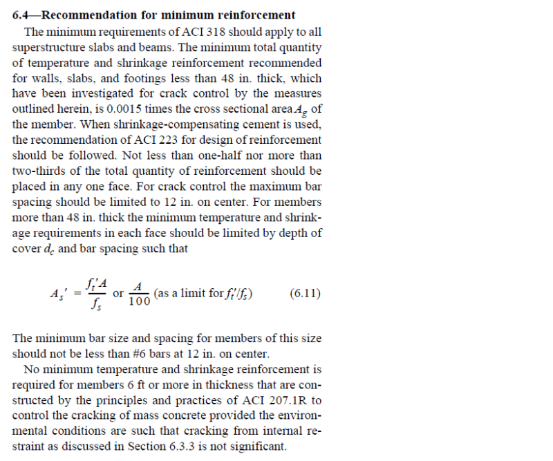

I am having a Pump Foundation of 4.6m Length X 2.3m Width X 1.7m Depth. As per ACI 207.2R. A minimum of #6 Bars @ 12 Inch Center to Center Provided.
Is this reinforcement to be provided on each face only or to be provided as a cubic reinf as shown in the attachment below.
https://res.cloudinary.com/engineering-com/image/upload/v1482852068/tips/PF-Long_View_nviroa.pdfhttps://res.cloudinary.com/engineering-com/image/upload/v1482852080/tips/PF-Transverse_View_tu09yd.pdf
Please also specify the minimum reinforcement for the Dynamic Pump Foundation

Old DIN rule is 50 kg/m3 of spatial reinforcement (like your sketch) for dynamically loaded foundations
