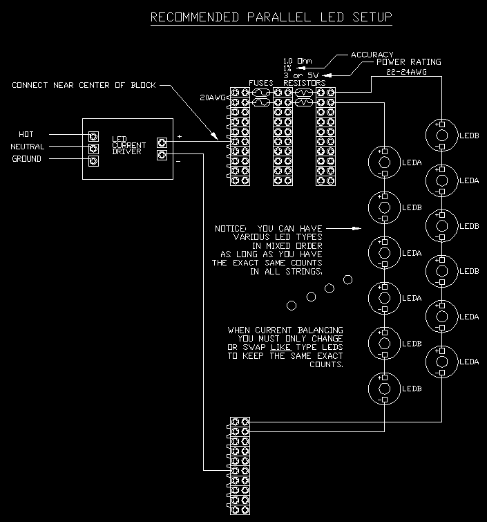

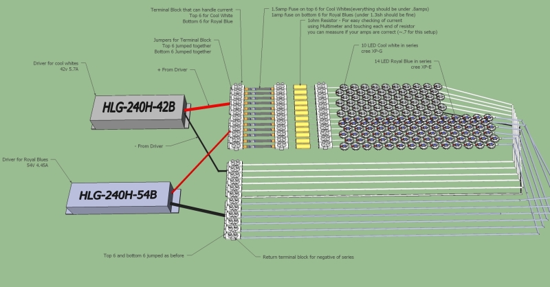

RE: A Current Balance Circuit for LED Strings in Parallel with Polyswitch Protection
I was one of the 'first responders' in the very DIY aquarium world working with the original Cree high power LEDs(HPLED). I worked up how to do it cheaply but dependably.
This was what I came up with and was followed by hundreds of DIYers.
That was quickly formalized by commercial sites into this drawing:
If you want to go inexpensive this works. I have this lighting my living-room and am typing by it now.
I'm about to build a replacement for my kitchen ceiling as yet another #$%@@*^ fluorescent tube as failed and I never want to see or deal with another one. However, I'll just use a couple of individual drivers so the thing eventually fails gracefully.
Keith Cress
I see the bottom drawing also uses XPG3 LED's.
There are a lot of options, each with its pro's and con's.
I am looking to build PWM circuits that could be optionally connected to the Driver during experimentation.
The default operating current will be 1050mA from driver, a 555 PWM can be connected with values from 50 to 99% duty.
Or 500mA to around 1A adjustment.
The question still hanging is how best to balance 2x 150v strings of 50 LED's @1050mA.
