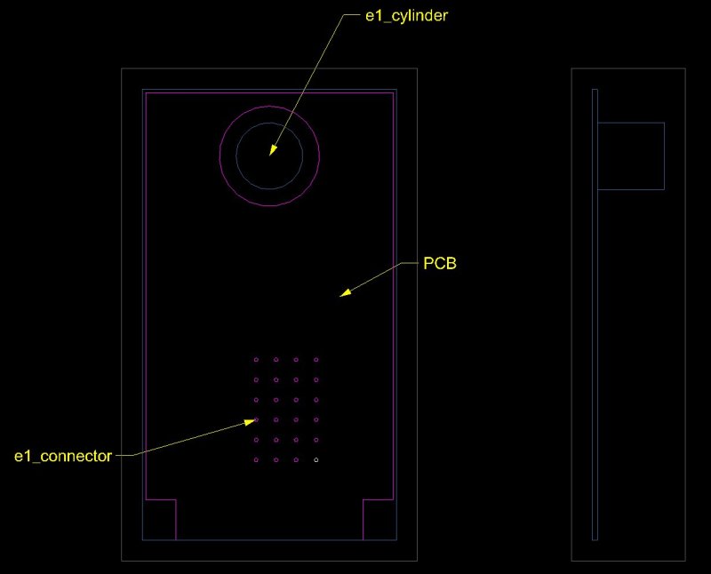

Blank and unblank work in dwg modeling mode but not work in dwg drafting mode
Hi
These pictures shows that
Please can anyone Help to explaine why.
parts also atouched.
Using NX8.5
Thanks in advanced
and this is the views style

the "e1_connector " is that the green card we see in the images ?
You show two screenshots of 3d model, and then the "View style" dialog which is used for drawing views. I do not understand the connection here.

Thank you Tomas
yes the two screenshots of 3d model are drawing modeling mode
and here is drawing drafting mode
as you see the "e1_connector" is a component that contain curves only a circles group
and in drawing modeling mode has no efect on the "e1_connector" (blank unblack no work)
but on "e1_cylinder" that is a component of a solid cylinder the blank unblack work on drawing modeling mode
but in drawing modeling mode both "e1_connector" and "e1_cylinder" the blank unblack work

RE: Blank and unblank work in dwg modeling mode but not work in dwg drafting mode
Did you try update the view on the drawing , after you did the Hide ( Blank) on the e1_connector ?
When changes have occurred on the Model, NX should normally recognize this and show the "clock" on the view and the drawing in the Part Navigator, but i have seen that if the change is curves only and not solid bodies, the clock might not appear.
Right click the view - Update .
does this help ?
Yes that help
Thank you very much
because the solid component not need this
Update I don't think it for the curves component.
When you place a view on a drawing, NX will copy all the visible edges of the solid , the copies will be curves, lines , arcs etc
Pre V9 this had an option of it's own in the View Style Dialog, "Extracted edges".
After V9 I have not seen this option and I assume the extracted edges are mandatory.
One of the reasons for the extracted edges is that you can open the drawing only ( No need to load the assembly) and continue working, add annotation , print/plot/pdf/DXF etc
This is also part of the reason you need to update the drawing views, if a change has occurred NX needs to re-evaluate what is visible and what is not.
(plus the calculations to find out what edges should be hidden and made dashed or invisible.)
IF the model is large/complex etc the update can or will take computing time and you will therefore have to do a manual "update views".
If you only do small/simple models you can set NX to do an automatic update as soon as you enter the Drafting application.
Model Curves are by default not part of these calculations, ( they can be by toggling the "include model curves" option in the view style dialog)
i therefore assume that the curves aren't copied in the "extracted edges step".
